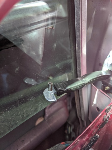

So our 2004 Vibe has the same problem with the window hitting the door strap , it's actually broken 3 straps now so I decided to finally fix it for good.
I bought another new strap , ground off the part the window was hitting , drilled a hole in the middle of the strap end and installed a roll pin .
I also took a large screwdriver and jammed it into the old door strap holder without the strap in place ,and pulled outwards , bending the front side of the door back into place .
It seems to have worked because now I have around 1/4 inch clearance between the strap and the window .
