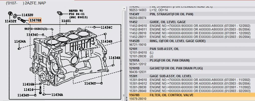

2009-10 2.4L owners, Anyone replace or clean the oil control valve filter?
The parts site list a part:
FILTER, Camshaft Position ACTR Solenoid Valve, Stock Code: 19185369
And have a nice diagram, but I can't find it on the back of the engine due to access
The plug/bolt spec is listed as: (M14X1.25, 13MM LONG)(22MM HD W/8MM HEX RECESS), so it should be larger than anything around it
What's needed is a rear view of the engine

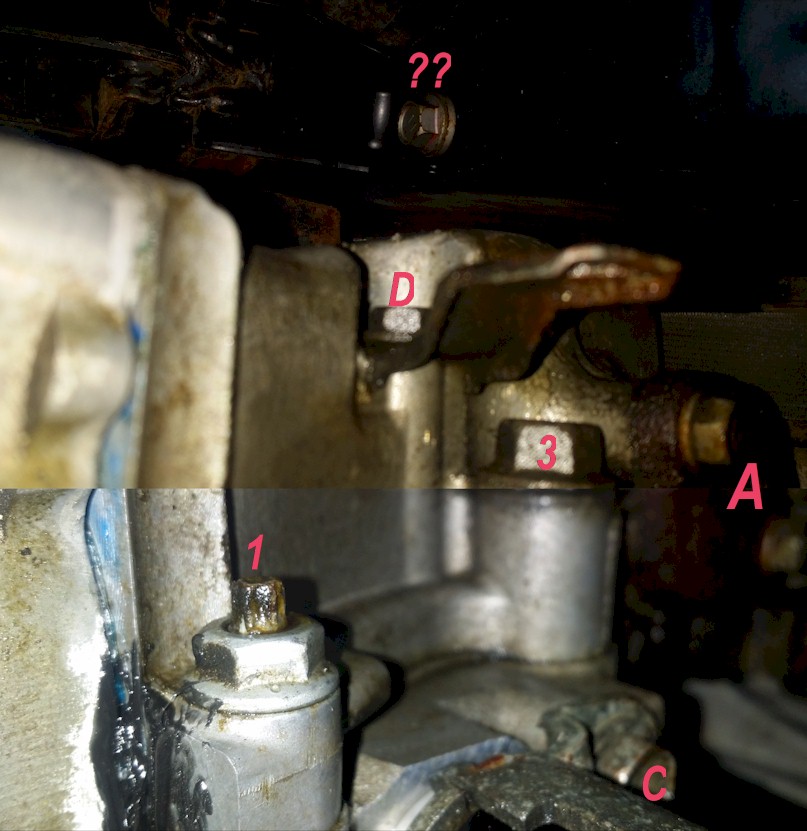

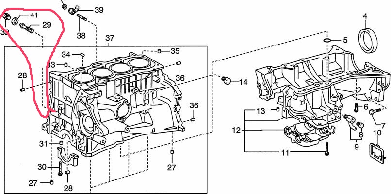

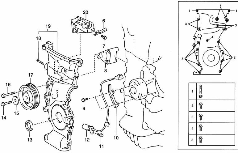

Found a view more engine views online,
....Would be nice to have a back side view, or a side view that lists all the parts and bolts
Then I took a barrage of pics, and pieced them together
The smaller image is a view looking down from the top of the engine bay, the second larger image is from the ground pointing up towards the backside from behind the passenger wheel. This is all that can be seen without taking off the intake manifold, and I don't see the filter bolt anywhere.
I numbered items in comparison to the prior diagrams
A is the plunger and it's two bolts, B is a bolt holding on the clip/hanger, C is the bolt holding in the solenoid; ?? is in the bottom of engine bay

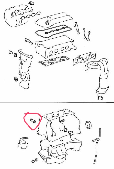

Found a new pic that details all the gaskets for the engine area in a gasket rebuild kit
And again, this magical unicorn is shown - the bolt holding the filter in has a gasket. It's in line with the vertical orientation show in prior images above, about in line with the cooling intake where the thermostat is housed on the front.....
Maybe the Intake Air Manifold is hiding it as I kind find everything else but this [see pic above]
