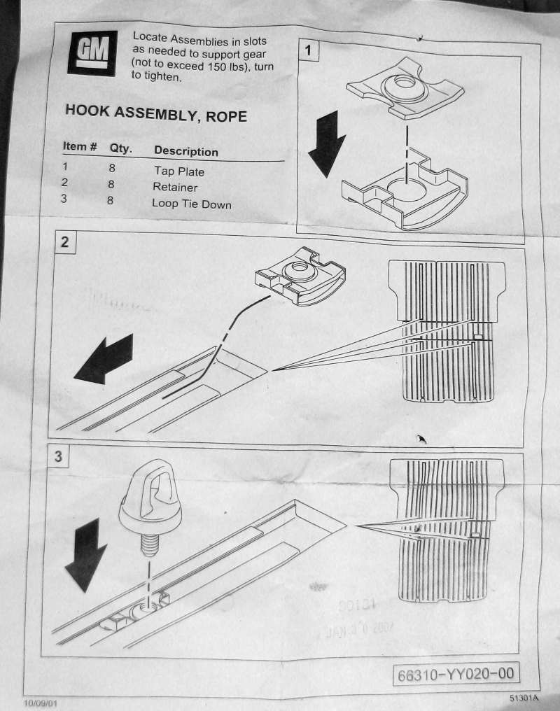

In the first gen vibes, there are tracks on the hatch area deck and on the rear of the rear seat backs.
They originally came with a bag of custom retainers that fit in the slots and can be positioned as needed to provide a tie down point for securing cargo. If you bought the Vibe used, then it may or may not have come with these retainers. Originally, in the bag, there is an instruction sheet showing how to use the retainers, and I've attached a pic of that instruction sheet.

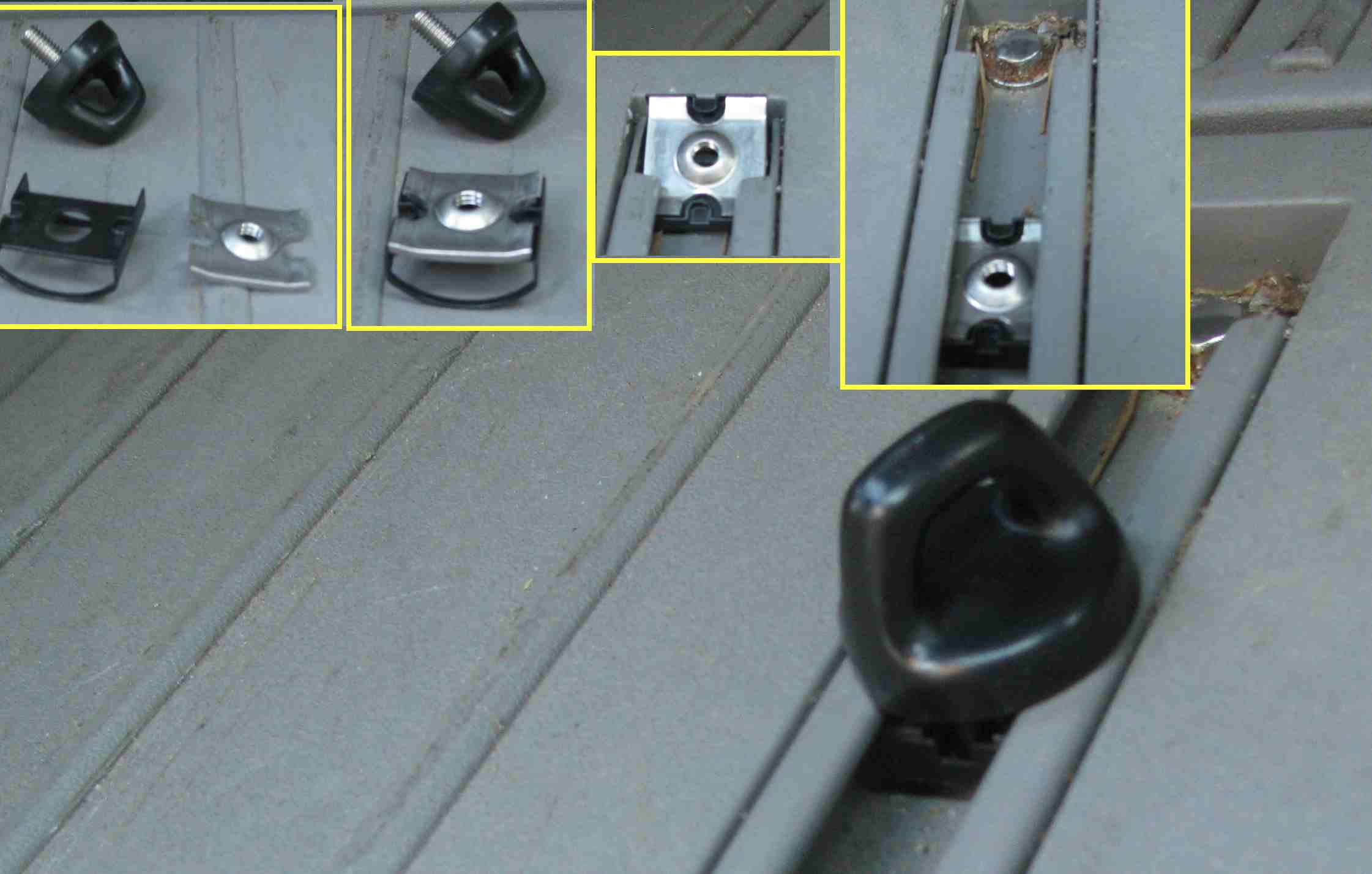

In the bag, there's 8 spring pieces, 8 nut plates, and 8 screw in loops. The instructions call these "tap plate", "retainer", and "loop tie down"., respectively
Look at the instructions, the first step is to put a nut plate on a spring thing, then slide this into the track. There are wider openings at one end of each track, as shown in steps 2 and 3. Then, screw the loop end screw thing into the nut plate, slide it to where you want it, and then tighten it.
I also attached a picture that kind of shows those steps.
If you don't have the custom hardware that came with the car, probably best to try to find a set on;line or at a junkyard instead of trying to come up with some other stuff to use in those tracks.

joatmon wrote:Originally, in the bag, there is an instruction sheet showing how to use the retainers, and I've attached a pic of that instruction sheet.
Thank you! This was very helpful. And just one more thing that makes the 1st gen an awesome vehicle!!
