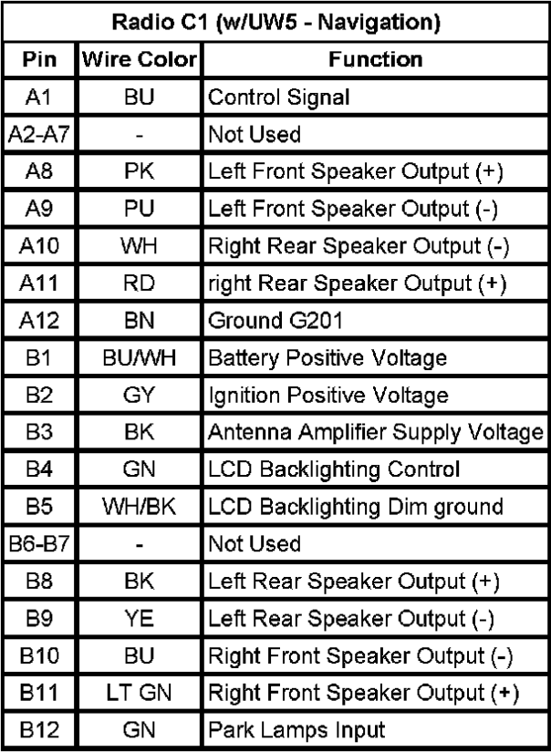

gtv237
Posts: 387
Re: Looking for 1st gen W/ nav wiring diagram
Post by gtv237 »
2008
Radio UC6, US8, Speakers UW4
Radio U1P, Speakers UW4
Radio Monsoon U1P, Speakers U65
Digital Radio Receiver and Subwoofer U1P, U2K, U65
Radio and Remote CD Changer UC6
Radio C1 (w/UW5 - Navigation)
Radio C2 (w/UW5 - Navigation)

Sorry guys, I didn't realize the wiring could be different on first gens. I forgot about the whole 05 refresh deal. My vibe is a 2003 GT. And THANK YOU to all those who posted up wiring diagrams!!
