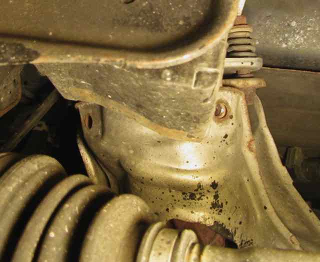

Had similar issue on '05. Appears it may be a common problem in the rust belt. Did not have any rivets big enough, ended up using a hose clamp to keep the heat shield in place. Used arge hose clamp to secure shield (102-152mm Stainless clamp worked fine). Plugging open bolt holes with exhaust repair compound, used Permatex MTK-1 Item 80335 (used before on several other projects holds up well).
Missing bolts, open holes in exhaust manifold letting gasses out
Hose clamp in place and holes plugged.
