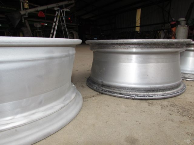

Pics of the progress, sandblasted left, as removed right:

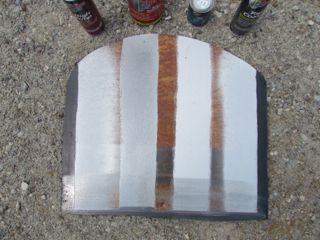

Paint samples, picked four aluminum colors, painted rough plate, then tested clear coat finish. With only one day dry time between color and clear coat some streaking occurred. Learned that needed to wait about three days before first clear coat application.
