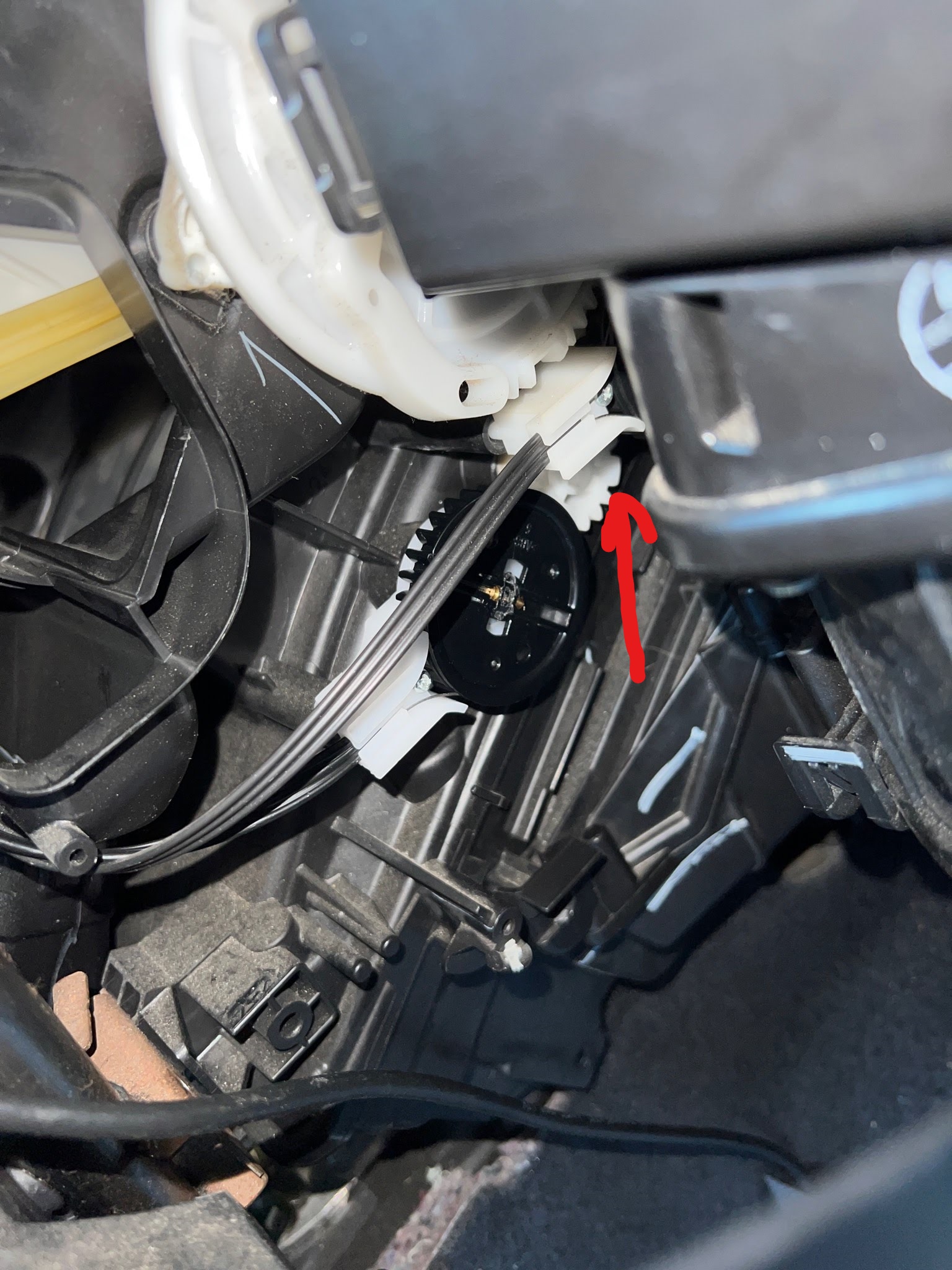

I had this issue with my 2010. My temperature control cable got damaged/stretched as there was somehow a glow stick stuck in the blend door.
This is for the far right control knob with the AC switch/light.
5590926080 was the correct replacement cable - ebay for $22. Pop out the central dash and glovebox, pull the HVAC panel and remove the old cable. I also popped off the passenger floor vent of the blend box for more working room.
When you're installing the new cable & gear it's a bit difficult to feed through.
There is a hole that needs to line up with the new gear and it will snap in. You also need to make sure the black and white gears mate up at the "square" cog. My photo shows it NOT lined up properly and needing to be rotated.
