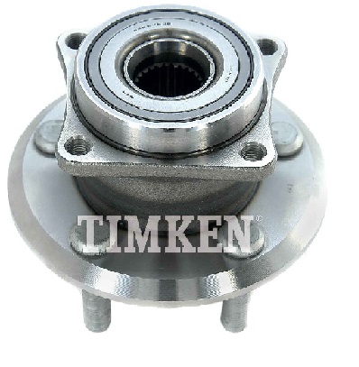

The rear wheel bearings come with their hubs as well. Since I am planning to change both rear bearings, they are a little expensive for my budget from the dealer. But I was looking at the Timken HA590002. What do you think about their quality? Any other suggestions?
Timken has been a good brand name product along with SKF. Bearing manufactures will trade parts with one another to cover their product lines. Do not be surprised to find that the Timken part has a different brand bearing in it.
Great, as long as they are known for being quality brand, I am okay with it. I am actually ordering two of these Timken ones from AutoZone locally. They have 3 years warranty with them. (I also found a coupon and it reduced the price by 20 percent :D ).
