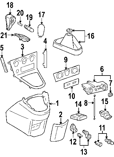

I've got a 2003 Vibe with a broken "Front Console Compartment" - #2 on the attached diagram.
The latch doesn't work anymore and when I disassembled it, I found that the spring and the catch were both broken.
So, I bought a new one, but GM Parts Direct is telling me that I also have to pair up the new compartment with #1 (Front Console Base).
I got the new compartment and, sure enough, the new compartment doesn't latch with the old base. So I'm planning on buying the base now.
Here's my question:
What is the best way to remove the old base and install the new one? I know these interior pieces can be temperamental if you don't pry them at the right points, etc. I don't want to do more damage to the interior, but I don't even know where to start figuring out how to remove the panel.
Has anyone removed their front console base before? What's the trick?
