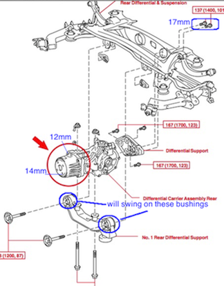

1 remove the 4 bolts on the drive shaft connecting it to the trans coupling assembly
2 remove the two 17mm bolts holding the diff shown in diagram (came out easy)
-at this point the whole assembly will swing on the diff support ***(((((you don't need to remove half shafts or any other bolts)))))***
3 to separate the drive shaft, i needed to give it a few waps with a hammer and chisel in the gap between (support it with an old box or something)

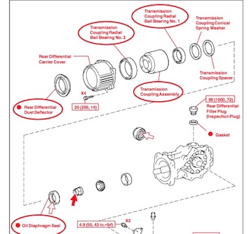

4 remove the 4 bolts holding the carrier cover
5 tap the carrier cover off the diff
6 remove the dust deflector (mine just popped off when i removed the cover from the diff)
7 tap out the coupling assembly from the carrier

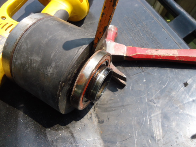

8 i used a chisel to remove the old bearings (they came off pretty easy)
9 i used a brass drift to TAP the new bearings on (didn't have any problems)

10 tap the trans coupling assem into the carrier
11 tap on the dust deflector (i couldnt get the new one on and had to reuse the old one)
12 remove the spacer and spring washer (should still be sitting in the diff)
13 pull and replace the "oil diaphragm seal"
14 put the spring washer and spacer back (red mark to front of car)
15 tap the carrier cover back on the diff and reinstall the bolts
16 bolt the drive shaft back on then reinstall the two 17mm bolts
