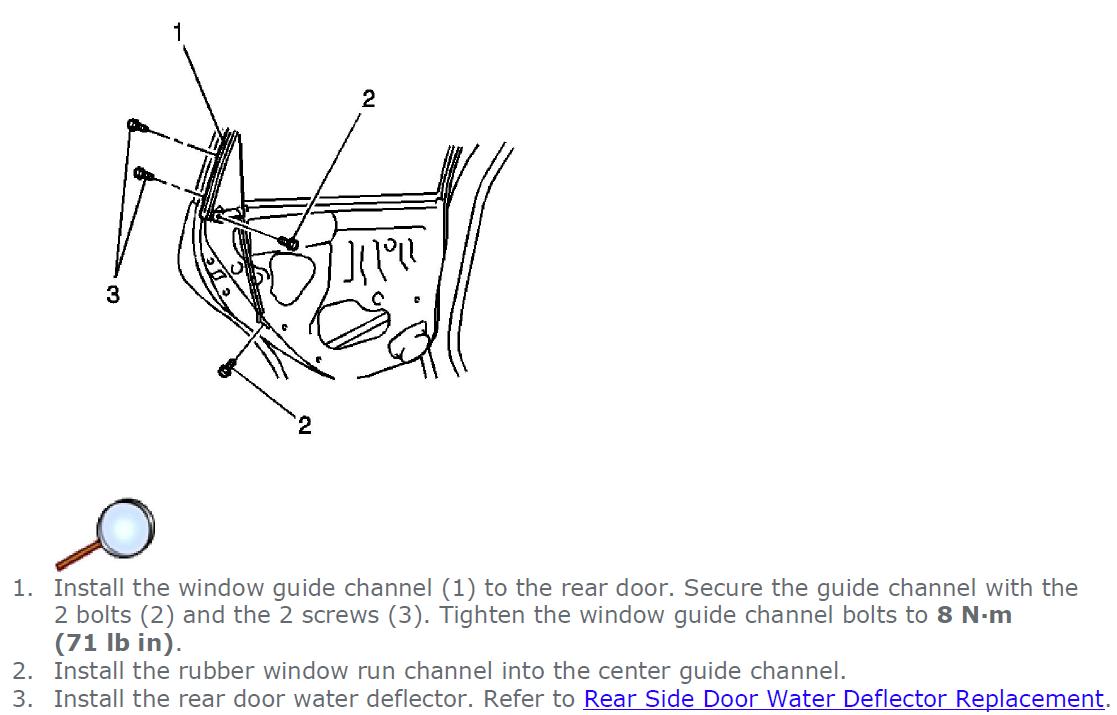

I do not know if this would apply but posted this information to give you some ideas as to how you may get the glass in. I have no info about the earlier model but as no one else was helping, I will give you what I have if that helps you out.\
rear window guide.jpg (65.64 KiB) Viewed 4592 times
Toneloc
Joined: Thu Jul 24, 2014 6:27 pm
Re: Rear Door Replacment Window
Post by Toneloc »
Thanks for posting...this helps.
I didn't notice the 2 screws (item 3 on the diagram) that come in from the door frame to hold that triangular piece (item 1 on the diagram) in place.
I guess that triangular piece is the rear water deflector.
Thanks for the help.
