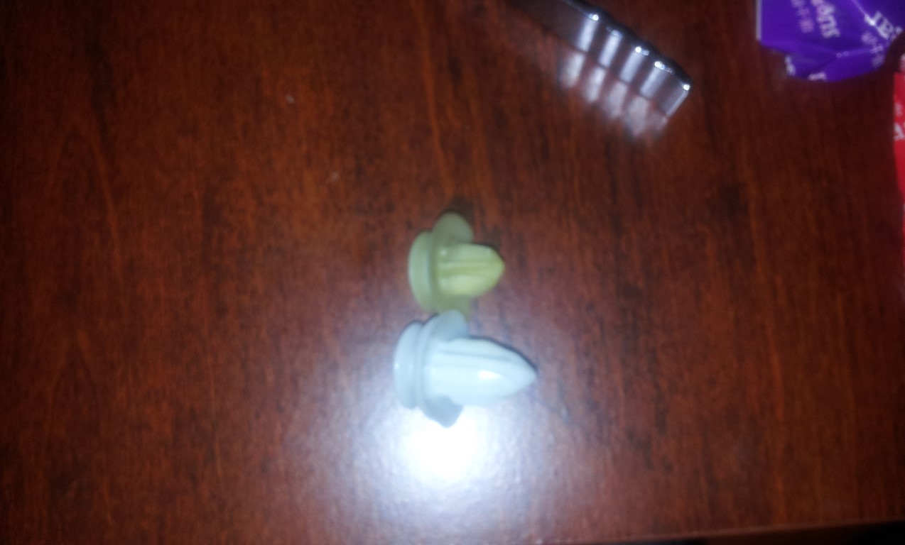

second Issue is the these plastic stuff that seems to be broken and i dont know what they are called or where to order them :
IMG_20140519_041003 (Medium).jpg (106.94 KiB) Viewed 2636 times
Thanks in advance

As for those plastic clips, take them into your local Toyota dealer. They'll be much cheaper there than buying them from GM.

Where did the plastic fastener come from? You may be able to find a part# by finding the part on a diagram. You can also take it with you to the parts store or dealer and try to match it up.

That clip looks like it could be from a door panel. If you take the clip to a good parts store, they should be able to match up something that will work to replace it. As for the spark plugs, if you think you will get another 100,000 miles out of the car, then go for the higher end spark plugs. Just an old regular spark plug while go 20,000 miles on a good, clean running motor. I go for the cheaper spark plugs as my motors get high mileage on them and change the plugs more often. It is about how much do you want to spend and how often do you want to change them. If the car doesn't have 100,000 miles left in it or you are going to sale it before that, way spend the money on spark plugs you are not going to use?

I was able to find those clips on ebay. should be <$10 for a pack of 20 or 25, usually with free shipping. You have to wait a week or so to receive them. They are used throughout the interior panels and I can't say they are as good as the originals, but they are holding well. I wouldnt' expect that they can be removed and replaced many times. I couldn't find the equivalent at NAPA or any auto parts store.
