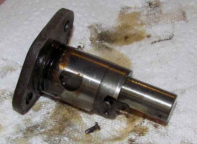

Completed the o-ring swap today. Almost had a mishap, while resetting the tensioner the catch pin fell out :?
The tensioner was otherwise fine, took pin over to the vise flattened the shaft a bit, then used the vise to gently press the pin back into the end of the tensioner. Worth checking the part before reinstalling the tensioner. It could have fallen out into the timing chain causing damage on its way to the oil pan.

Chiadog
Posts: 971
Location: Abrams, wisconsin
Re: OIL LEAK Timing-Chain-Tensioner-O Ring Replacement
Post by Chiadog »
Derf wrote: Almost had a mishap, while resetting the tensioner the catch pin fell out :? ..... Worth checking the part before reinstalling the tensioner.
WOW, Close call! Do you suggest just "wiggling" the catch pin to insure it is more than finger tight? Nice repair, gives new meaning to the term "press-fit".
Derf
Posts: 531
Location: NW Ohio
Re: OIL LEAK? Timing-Chain-Tensioner-ORing-Replacement
Post by Derf »
I would suggest wiggling the pin. The pin fell out while I was cleaning the tensioner. Was going to set the latch and the pin was missing. This appears to be the 2rd or 3rd time the tensioner was installed, previous mechanic could have knocked it loose, allowing it to fall the rest of the way out while I was scrubbing the tensioner.
