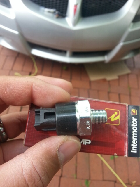

Oops, I forgot to update!
I guess the cab cleaner I used to clean the housing got onto the oil pressure sender. It was leaking oil out of the housing! A trip to advance and $8 later, the leak is gone! Thanks!
