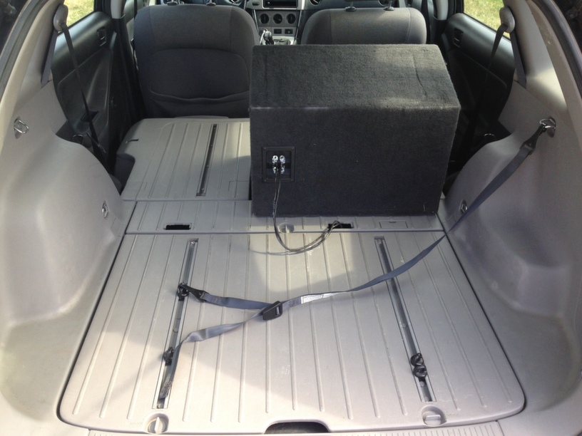

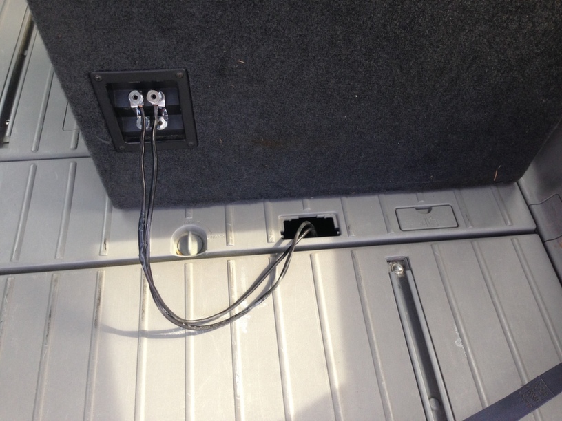

The Speaker wire for the subwoofer was also a little tricky. I didn't want to drill a hole up threw the floor panel, just encase I do sell the Vibe (but I love it to much to do that!) so I drilled holes in the both the spare tire compartment and also the small compartment behind the seats, and just left out the plastic cover for the Tie downs.

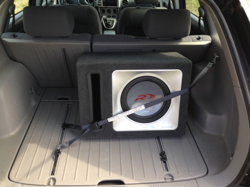

For the Amplifier I looked for a digital Amplifier that would stay cool and give me enough punch to satisfy the money spent on this project. :D The Alpine MRV-M500 was just the perfect choice! I have had the Alpine 12" box for YEARS and replaced a blown alpine 12" with a slightly used Alpine Type-R that was in a Dual subwoofer box... Specs are 500 watts RMS and the alpine amplifier is 500 RMS. (532 on the certificate of testing for quality and control) So the Amplifier pushes more power then the Subwoofer :D
Iv had this install for a couple months+ and I LOVE IT! So easy to move the Subwoofer if I need to get to spare tire or to haul anything. And my sound quality is amazing!

Moves Easy!
Moves Easy!
Speaker Wire
Speaker Wire

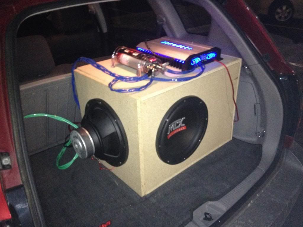

Awesome stuff! Just because this topic is called smooth look subwoofer, I had to share my not-so-smooth-looking subwoofer set up I used to be running in my 06 vibe gt Image But is it really loud? YEP :D and that's the way i like it
