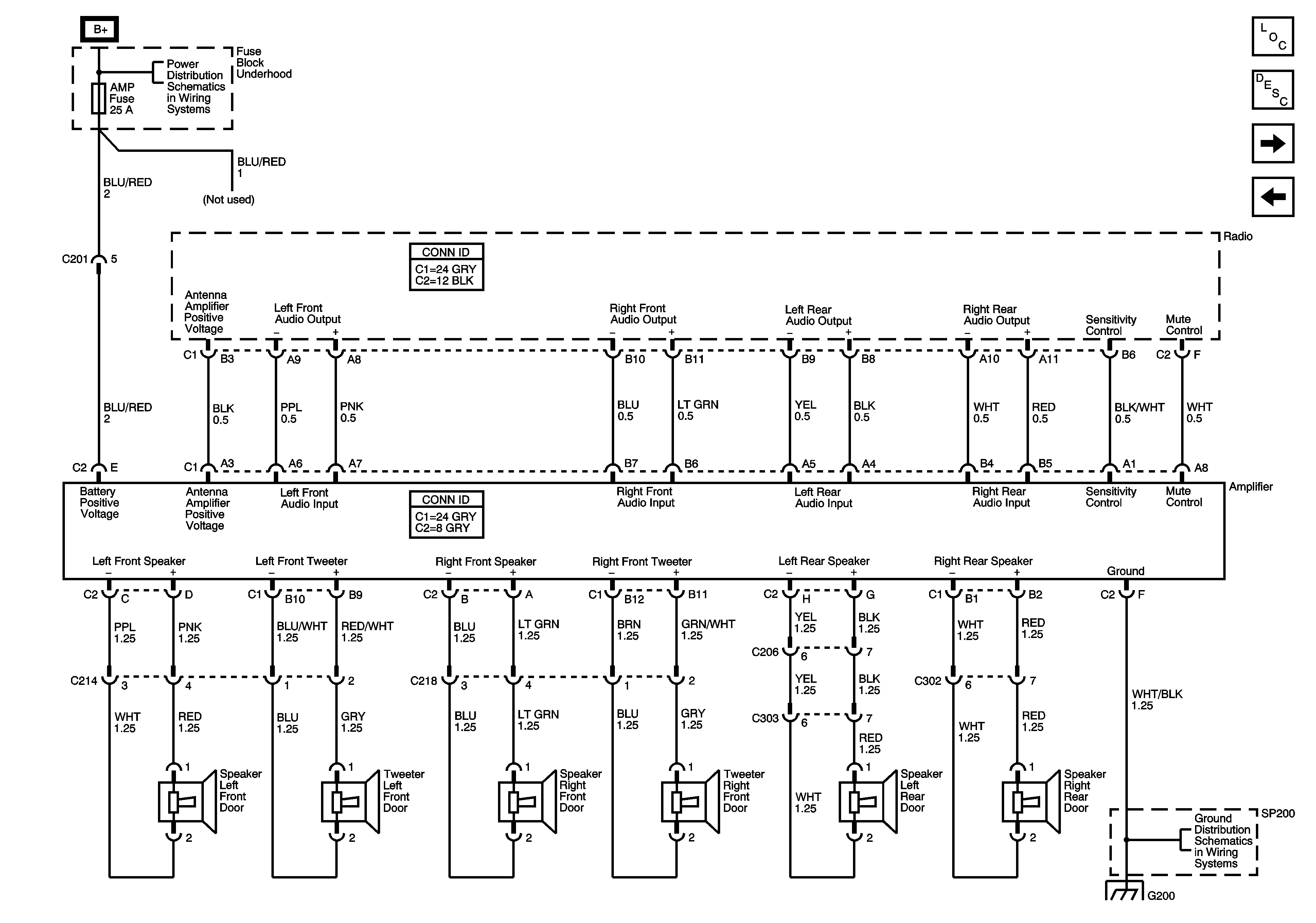

You could look at this attached diagram, and with the amplifier removed, connect head unit output to speakers. You could do that one speaker at a time temporarily with jumper wires to see if the speakers still work, or connect them up permanently and just go with it. The tweeters near the side mirrors might need a crossover or you could leave them not connected.
