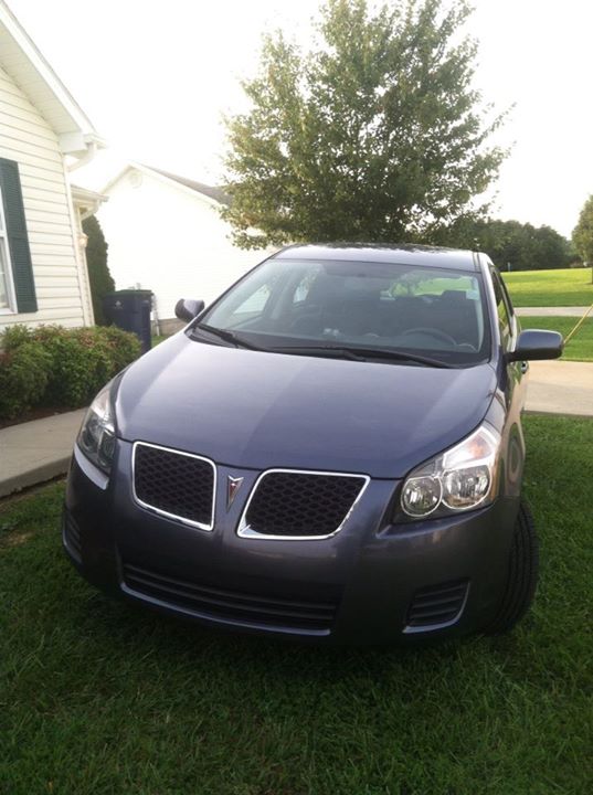

Welcome to GenVibe Brandon! Everyone else has pretty much answered your questions already, so I will just ask that you post some pictures of your Vibe when you get a chance. We love pictures around here :D!

Ooh... another Steel Blue Metallic Vibe! An absolutely gorgeous color! My mom's 2009 Vibe GT is the same color. It's my second favorite color after Liquid Platinum Metallic :P!
