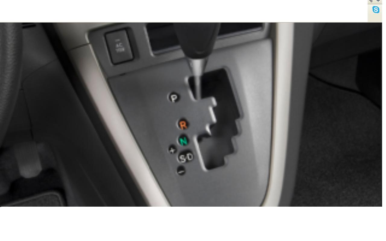

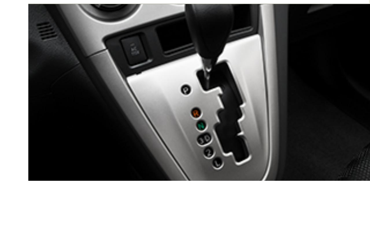

I don't know how the transmission could have been stuck on the second gear. See attached photos for the shift lever positions for the 2009 and 2010 Vibe. I have the 2009.

The 2009 came with two automatic transmissions: the 4-speed, which is pictured above, and a 5-speed with manual mode, which is pictured below.
The one you tagged as 2009 is the 5-speed with manual mode. Sounds like you were in manual mode and simply failed to shift the car to another gear.
Your car was clearly in 2nd gear, or maybe even 1st. Not sure of the ratios. Chances are the reason is that your shift lever just got bumped to the wrong position.
