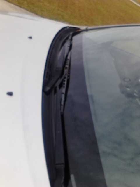

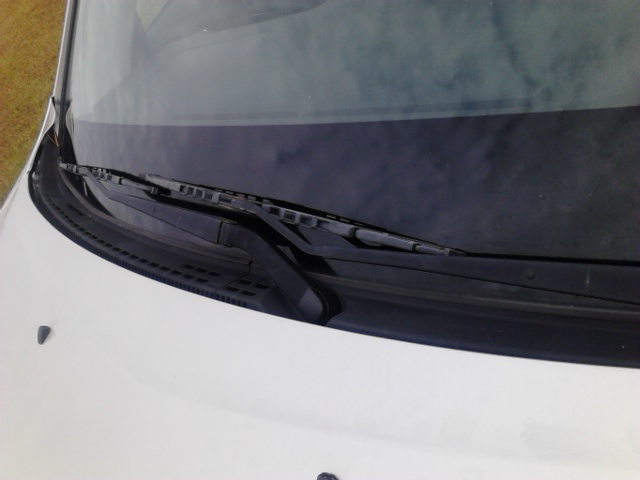

They have been like this since we bought the car used a few moths ago and was just wondering if they were indeed on incorrectly?

Your drivers wiper looks too long! should not be any overlap. My 05 Base is wearing a 21" wiper on the drivers side and 18" on passenger side and it looks normal! I'm sure someone can confirm if this is correct. There's about a 1.5" gap between wipers at rest on my car!

Yeah I know, but I've check 3 different sites and have bought and installed correctly the wipers, but what I'm wondering is if the wiper arm on there is the incorrect one for the car or better yet, what is the correct one and how do I remove the old one and correctly install the new one?

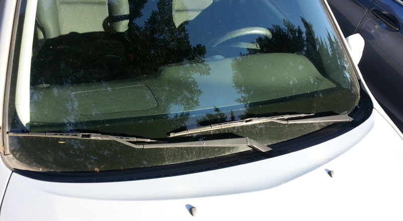

Here is a picture of my wipers.
The drivers side arm is about one inch shorter than the passenger side arm.
When the wipers are moving they should only touch glass.
I'm would guess the previous owner, or maybe the used car dealer, had the driver side wiper motor go out. Then, rather than replace it with the right one, they just installed what ever fit. The passenger side looks correct.

SeattleJeremy wrote:Here is a picture of my wipers.

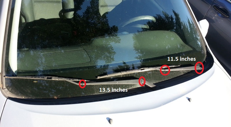

Measure the wiper arm's middle part, from the hinge to the solid metal part with the kink in it.
Attached is what I'm talking about. On my car the passenger side arm, between the marked areas, is 13.5 inches, and the driver side is 11.5 inches.

OKAY! Sorry for such along wait, with work and school and etc, I just measured them this morning, According to my calculations, the passenger side arm is 12 inches, give or a take .5 inch depending on how u and I measured, the right, driver side according to my calculation, which was more easier to measure also is 13.5 inches. So in my opinion I now have no doubt that they are indeed switched!
