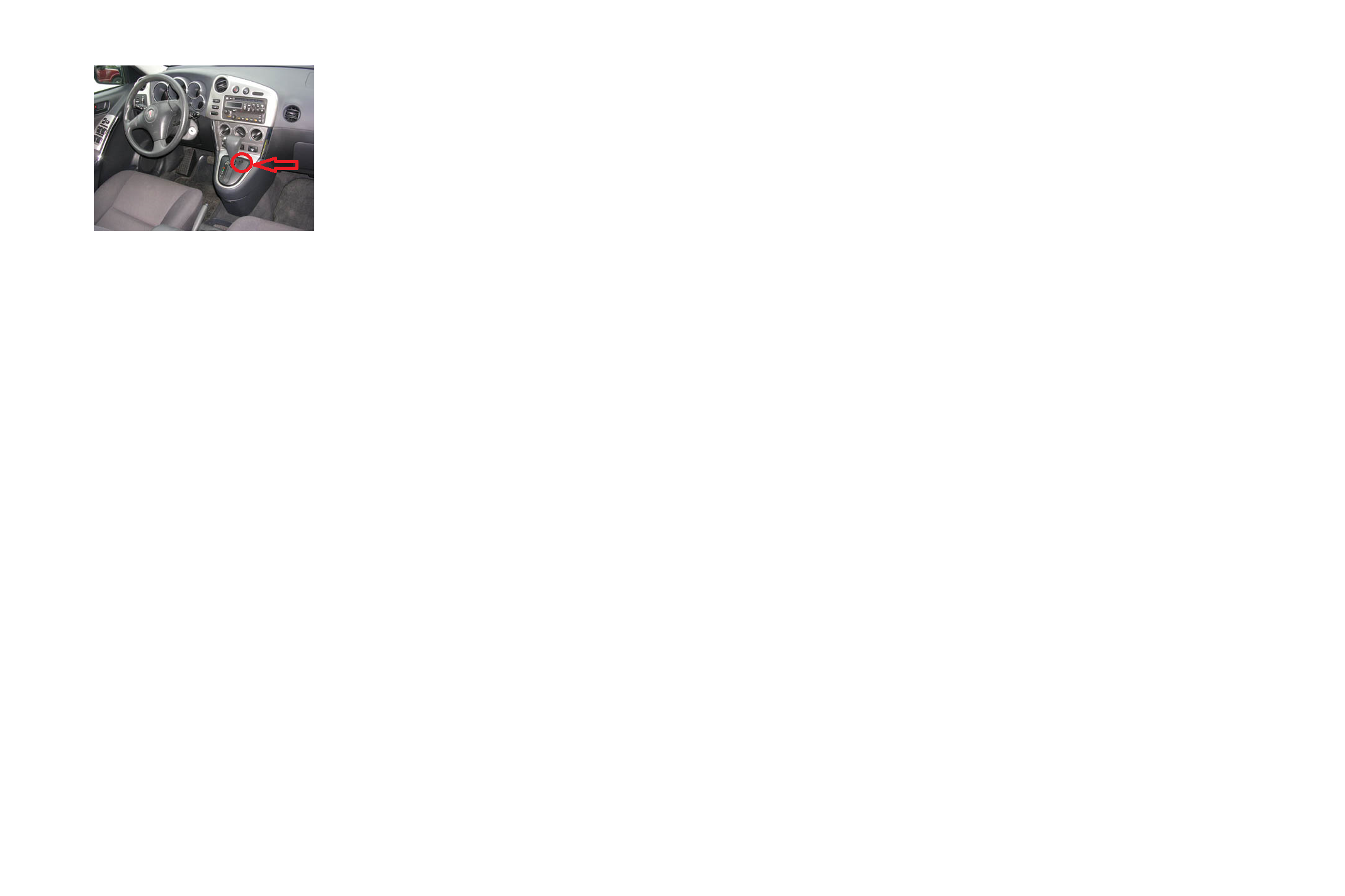

there is an emergency lock out switch near the shift lever. have you tried to re-set that? there is a small cover above and to the right of the shift lever. maybe that would help??

We have done the diagnostics from the service manual and all things point to internal transmission failure. :(

I highly doubt it. Do as the above post suggest. There is a locking mechanism that frees the shifter. You might just have something called torque lock.
