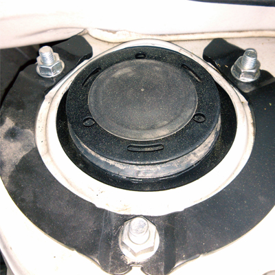

I recently replaced the struts on my 05 vibe. The back were a breeze but the front with the spring compression and everything was difficult. In addition the struts did not seat properly at the mounting point inside the engine compartment. I couldn't get the spacing even on each side like it was when I first took the struts off. I replaced all the rubber goods on the strut in addition to the mounting plate. Does anybody have any suggestions for fixing this?
This is the left side and as you can see it is canted pretty severely.
left side
left side
This is the right side and it is canted less.
right side
right side

my guess is when you tighen down the nut that the top hat was not seated correctly in the notch.
leave the weight on the car, losen the center nut a bit (caution doing this because of the preload on the spring)and see if you can twist the strut.

Ill give it a shot. Might just let firestone fix it since it needs to be aligned anyway.
