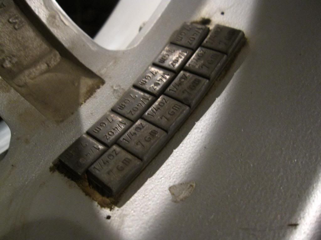

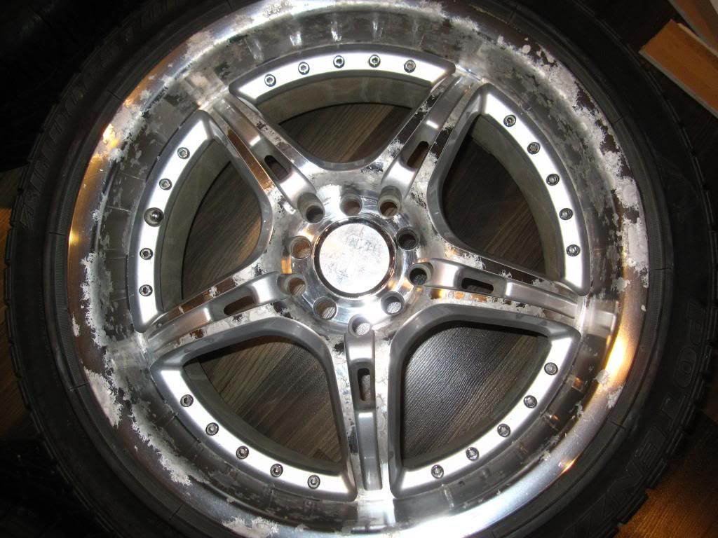

I bought a 2005 Pontiac Vibe last year, which came with some after market 17" rims on summer tires. One of the rims has a large amount of corrosion, this car was originally from Alberta, so I'm not sure how much road salt it was exposed to. Only one of the rims is in good condition, the rest have varying amounts of corrosion, here are some pictures of the worst one.
My question to you guys is, besides looking hideous, is it okay to continue using these? They have been balanced in the past, and I am going to get them balanced again when I take off the winter tires, because they appear to have corroded even more while in storage. I am a student and cannot afford new rims, so I hope I can just keep these ones for the next little while!

They look OK to me! I'd clean them up. Sand off all the corrosion and inspect them closely for any cracks. Use/Wear proper protection from the dust generated by sanding the rims, You only come with one set of lungs! Consider spray painting the rims to protect them from further damage.

I'm with Chiadog. It just looks like surface corrosion to me. Sand them and paint them or polish and clearcoat and they'll be good as new.
