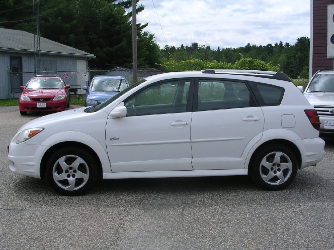

I am going to get a newer car soon and thinking about getting a Pontiac Vibe, around model year 2007. My question is about the body panels. Are the lower panels on the 2007 era models plastic like they were on the earlier models? I know they match the color of the car, but I'm not sure if they are metal or plastic. I saw one recently in a parking lot, but couldn't tell by looking at it and I didn't want to tap on it and set off an alarm or something.
Please see attached photo, which is an '07 Vibe.
Are the lower parts of the doors and the rocker panels made out of plastic?
The reason I ask is that I live in an area where they put tons of salt on the road in the winter, and I don't get around to washing my car that often in the winter. So my cars tend to rust out at the bottoms of the doors, around the wheel wells, etc. If I could get a car that had plastic at the bottom, that would be ideal.
Thanks for any help on this.

Welcome to GenVibe! On all first-gen Vibes (03-08) the lower body cladding is made out of plastic. It is held into the metal fenders and door skins by little plastic clips. Monotone Vibes, like my own or the one you pictured there, have simply painted grey cladding from the factory. So not much to worry about in terms of lower body damage, and it is impossible for the rockers on these cars to rust.... because they too are plastic. The fender flares kinda wrap around the edge of the fender, so little metal is exposed in the fender when you also remember the plastic wheel well liners.
But generally, I wouldn't worry too much about rust on these cars. Mine has been in Snow Country USA its entire nearly 10-year life! From Ohio to Massachusetts, finally to Minnesota, and I don't see a bit of rust on anything body-related, other than where paint was chipped off.
