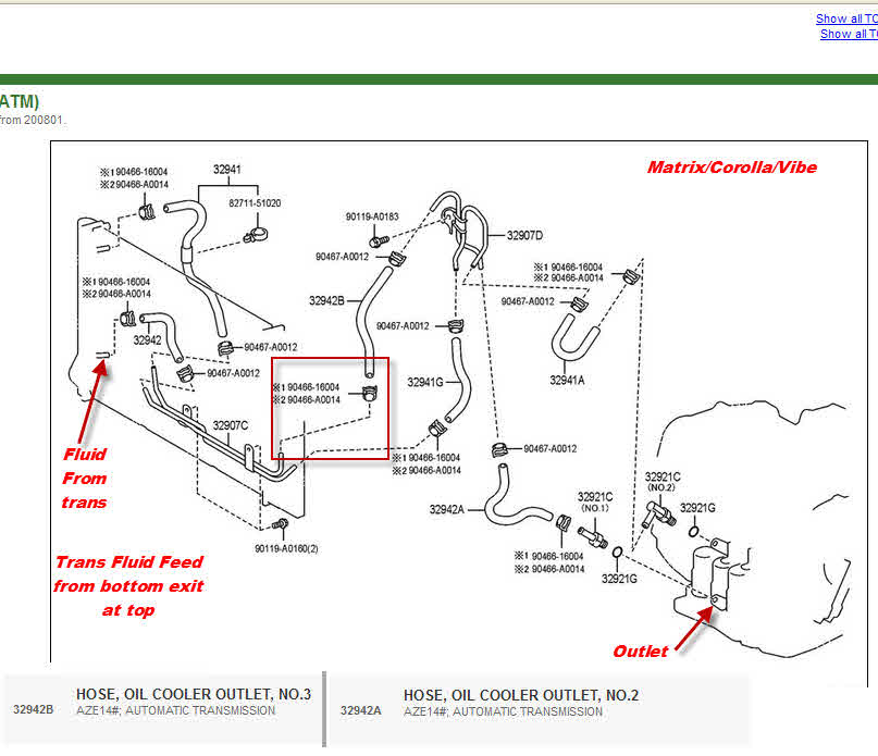

I found a good site on doing a complete /partial flush from T nation, Thanks Hardtop
http://www.toyotanation.com/forum/104-5 ... -pics.html
I also add the diagram for the best return line disconnect location
