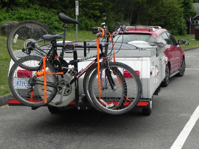

Ok, I just got back from the Maritimes 6000 Km camping trip ..
The car was doing very well, the only problem I had was the bike rack on the trailer bumper...
I did not do enough research on it , and find out the bumper is not strong enough...
I made it back home safe , but was a battle on the trip..
So now I am looking for alternatives ,on the trailer tongue
or on the hitch...
I did see one but they only work on 2" hitch, mine is 11/4"..
Any ideas???

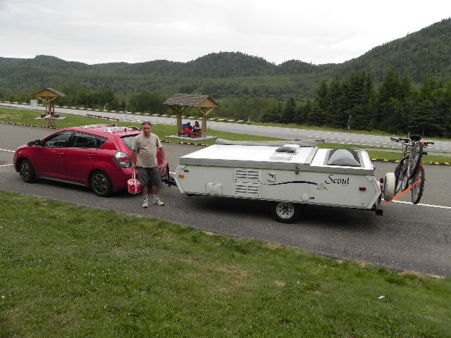

Some pictures of the setup..

Impressive! Is that a 1.8 or a 2.4?

Post by metaxa44 »
1.8 Base with tranny cooler installed..
I do not know the part number for the tranny cooler , just trusted my mechanic ...
But I am moving the bike rack on to the tongue of the trailer,because I almost lost the bikes and the bumper....
Too much stress on the back..

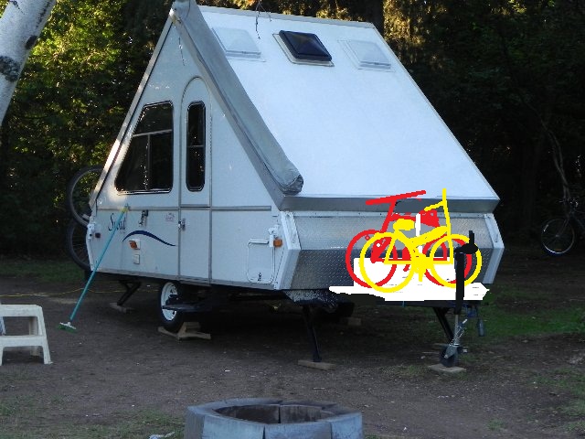

Planing to move the propane tanks and builed a platform for the bikes..
I will use 2 2"x8"x5' pressure treated side by side, bolted to the toungue..
Install a metal post ( white) in the middle to tie the bikes down...
I will only carry one tank and have it in a milk crate in the trailer while traveling...
