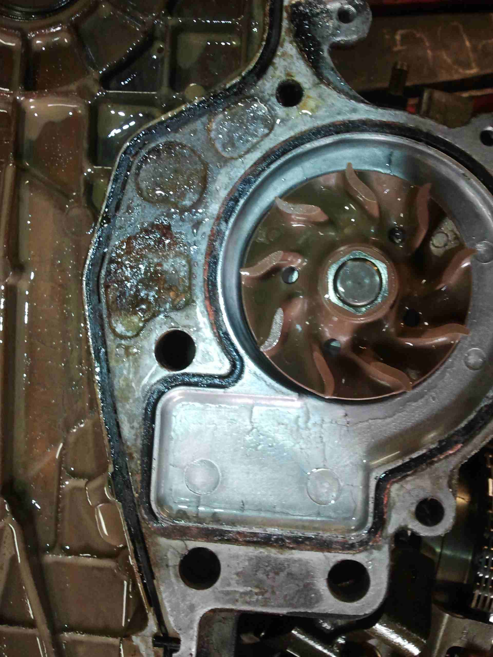

I think I found the problem. Looks like the timing cover gasket "blew" open between the water pump and the oil side. Odd to see both leak, but there is one point where both gaskets are close to each other. I have pictures and will try to post them. It's an interesting problem and seems no one else has had this occur - or has talked about it. Anyway, waiting for parts (pulled the engine to replace the clutch while I'm at it).

Sorry for not replying sooner. I finally did get the car fixed and running again. But learned a lesson. Never assume you found the true problem and put the whole car back together only to find out, it really was the head gasket. What happened was I thought we found the leak - the water pump gasket where it is 1/4" from the timing cover gasket. The picture shows the gunk between the two gaskets, which I assumed was the culprit. (Either way, it needed to be replaced)
WQell I fixed it, reinstalled the engine - and then found out I was still getting collant in the oil. Sheesh. I should have done a pressure check either on the cooling system or the cylinders. Either one would have shown me there was a problem. But . . .

So (back to the story) I got it back in the garage and took the head off and found the problem - a broken head bolt. Then I found a huge problem. The bolt was broken off about one inch below the top of the head. Since this is a GT (2zz) model, there are not that many replacement engines out there. So faced with the likely scenario that the car was totalled, my friend came up with an idea. He found a "guide", a hollow tube that was almost the same O.D. and the head bolt diameter. And an I.D. big enough for a ~1/8" drill bit. We wrapped some tape around the tube to get a tight fit, put it into the bolt hole and was actually able to drill into the broken stud and back it out (without hitting the threads in the engine block)! Hurrah!! and a big Yippee!
I really like my Vibe and hated to lose it. And I didn't. I got it all back together and only had about 4-5 bolts left over. :ugeek: It is now running just fine and just as fast/peppy/and fun as ever. Thanks again to this great site for all the help everyone gives.

Very cool. Thanks for posting the picture. I did not think about that location as a potential source of coolant and oil mixing. And good to hear the vibe is back up and running. Any idea why the head bolt broke in the first place?
