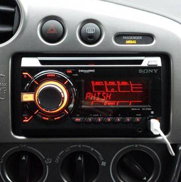

I just installed a new stereo in my 2007 Vibe yesterday, and would also recommend Crutchfield. I purchased a double-din Sony head unit (WX-GT80UI) for $149 and received all of the installation gear at no charge (dash kit, wiring harness, antenna adapter, instructions, etc...). It took me all of about an hour to install, and it looks and sounds great. I can actually run the amp and subwoofer in the hatch now, and I can also run/control my iPod directly through the stereo. I can even change the display colors to match the red inside the Vibe (even though it looks orange in the photo, it is actually red). Here's a photo...
sony 3.jpg (26 KiB) Viewed 5623 times
