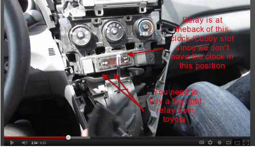

2. Installing the relay
Follow this beautiful video and remember to follow this person's force apply location for proper removal of the shifter and radio face plate without damage clips and become rattle trap.
http://www.youtube.com/watch?v=cOUtSCHhbk0
3. Install the fog light assembly.
You could jack up the car, remove splash shields and connect them to your fog light plugs.
Relay Location
Relay Location

vzDean1600
