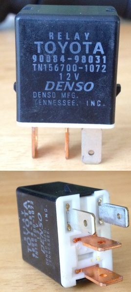

Fog light kit was for an 07+ Camry (eBay Seller: meautopart). I did not use the the wiring harness, bezels, relay or switch that came with the kit. I bought a multifunction switch from a Prius and a used Toyota relay.

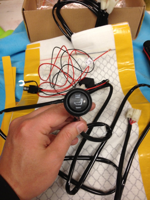

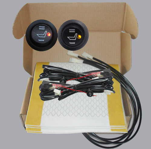

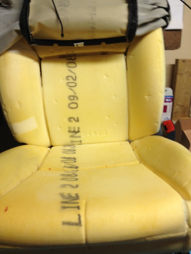

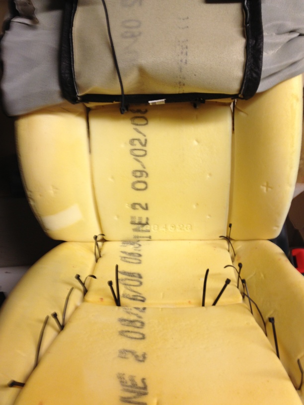

The heated seat kit was universal (eBay Seller: heatedseat). I'm pretty happy with the result. Here are some pics:
iPhone 4S 987.jpg (147.64 KiB) Viewed 12611 times
iPhone 4S 990.jpg (199.76 KiB) Viewed 12611 times
iPhone 4S 991.jpg (189.22 KiB) Viewed 12611 times

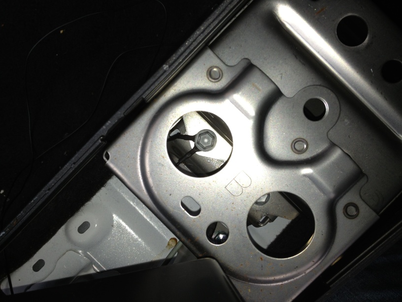

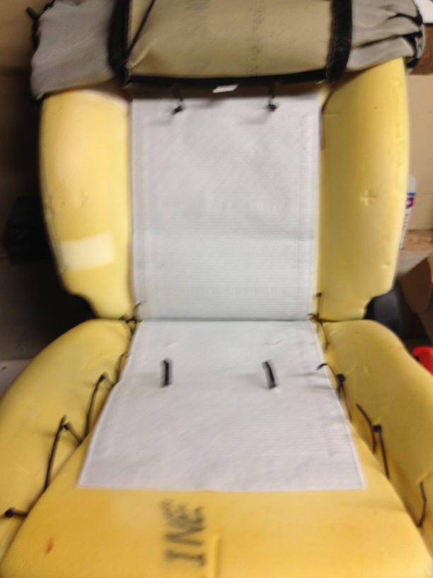

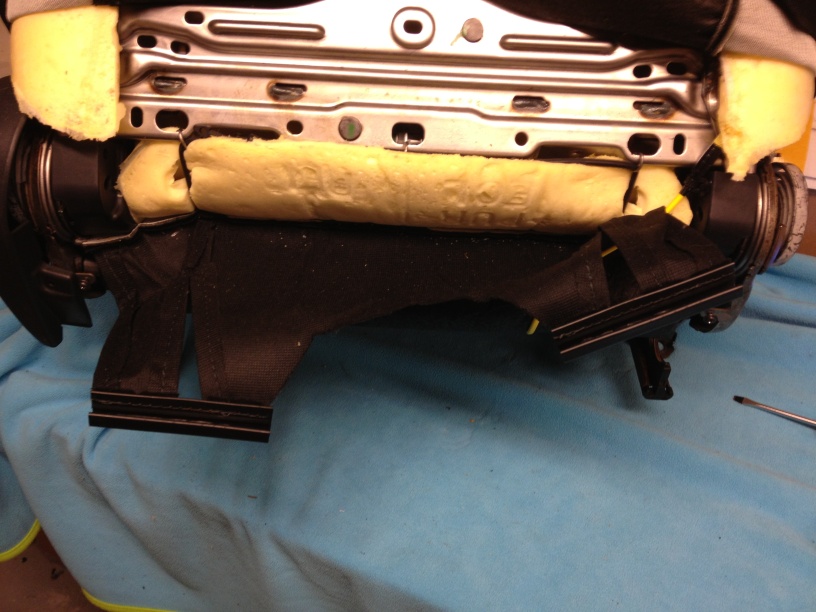

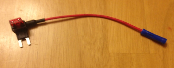

More pics from the heated seat install:
iPhone 4S 972.jpg (106.38 KiB) Viewed 12611 times

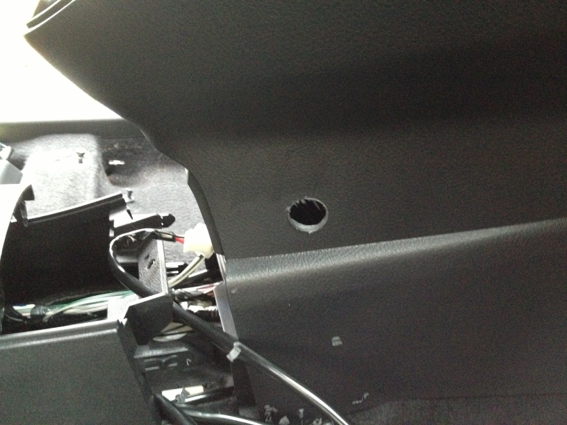

I didn't have to cut any wires. The fuse tap allowed me to tap into the power sun roof circuit.
iPhone 4S 974.jpg (50.61 KiB) Viewed 12611 times
Used a bolt near the hand brake for the ground.

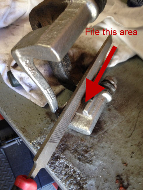

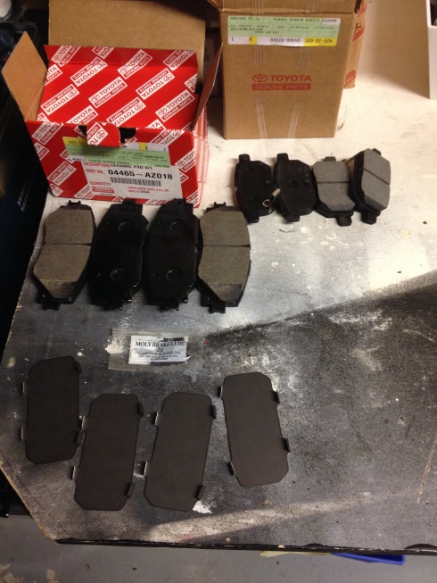

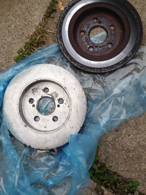

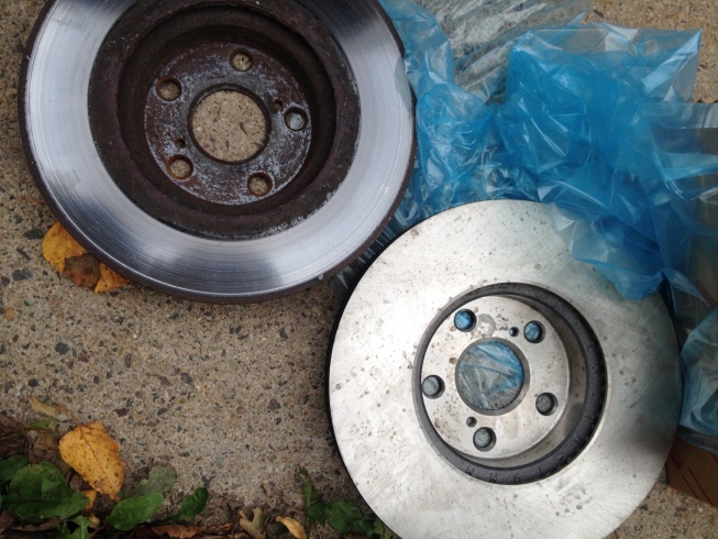

I replaced the rotors and pads last weekend.
I bought them locally since shipping to Canada and paying duty would probably end up costing the same. I ended up paying about $525 with taxes.
Front disc: 43512-02240 $79.95 each (you need 2)
Rear disc: 42431-02200 $79.95 each (you need 2)
Front pads: 04465-AZ018 $58.95 set
rear pads: 04466-02260 (replaces 04466-02210) $85.89 set
I used sample Base Matrix VIN: 2T1KU40E29C049168
Here are some pictures
I had to file the mounting bracket for the new pads to move freely.
File mounting bracket .JPG (87.4 KiB) Viewed 12132 times
New pads
New pads
Brake Pads.JPG (120.85 KiB) Viewed 12132 times
Boxes
Boxes
Brake Parts.JPG (101.99 KiB) Viewed 12132 times

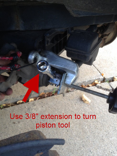

Here are some additional pictures:
I always hate turning in rear pistons but I discovered this method made it fairly painless. I had to file down one side for it to sit flush. I wish I would have thought of this a long time ago!
Rear Piston Tool.JPG (74.66 KiB) Viewed 12132 times
old vs new
old vs new
old vs new
old vs new

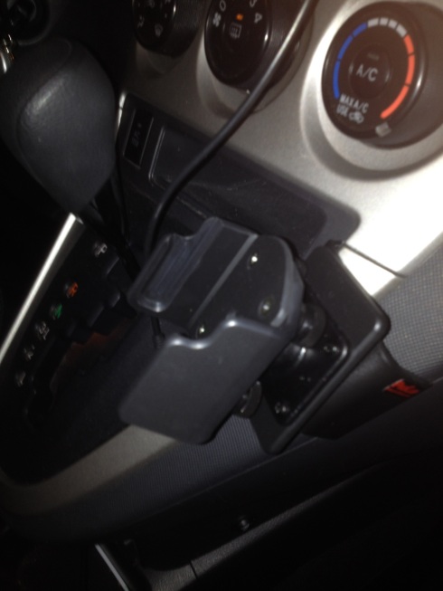

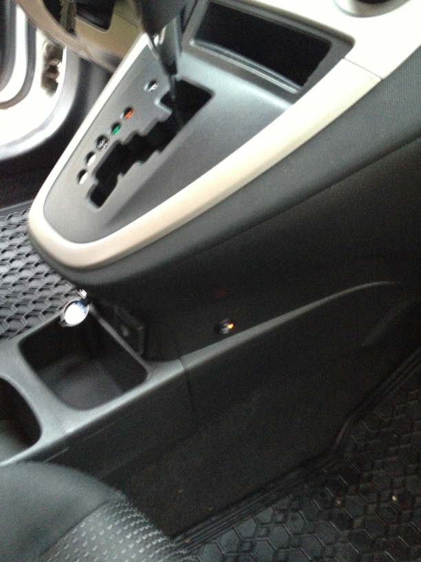

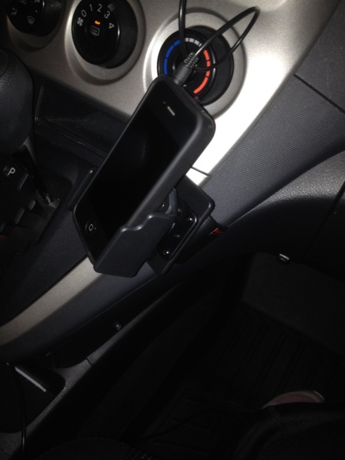

I bought a set up from ProClip USA. I should have bought this a long time ago. The fit and quality are very good.

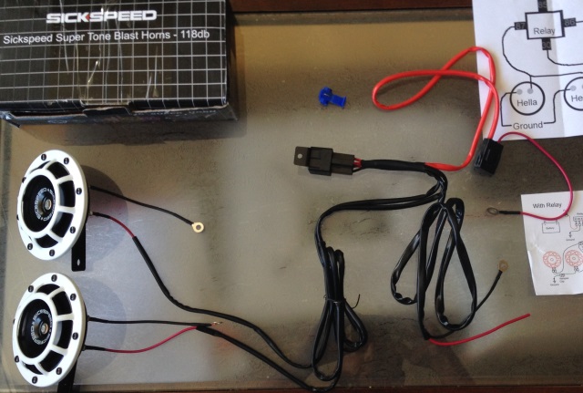

Aftermarket horns installed today. I like the tone of this horn much better. It is hard to tell but I'd say it is at least twice as loud. I bought it on eBay for about $80 with the wiring harness. The install was pretty straight forward. The oem wire uses a blase connector so I can easily revert back to the original horn.
New horns test fit
New horns test fit
sickspeed horn.jpg (57.43 KiB) Viewed 12033 times
OEM Toyota horn
OEM Toyota horn
oem horn.jpg (77.94 KiB) Viewed 12033 times
kit
kit
sickspeed super tone blast horn kit.jpg (93.21 KiB) Viewed 12033 times
