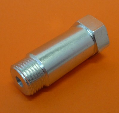

No, I have not try the defouler yet. what are the specs and where could I find it?
Re: P0420 Code After a New Fuel Injector! Please Help!
A defouler is simply a piece of pipe that takes the 2nd O2 sensor out of the exhaust stream. You'd have to make one yourself, piece of pipe threaded to accept the O2 sensor and then threaded/welded into the exhaust pipe. I suppose you might find one online.

star_deceiver wrote:A defouler is simply a piece of pipe that takes the 2nd O2 sensor out of the exhaust stream. You'd have to make one yourself, piece of pipe threaded to accept the O2 sensor and then threaded/welded into the exhaust pipe. I suppose you might find one online.
Yes, Thank you for your comment. I was looking for one online and this is very cheap. I am trying the defouler before jumping on an expensive CAT. This might buy me some time until I coult change the CAT.

They may have them at your local Auto Parts store. Normally they have the same threads as spark plugs and some times used for spark plug defoulers. We used them on a old car that bad rings to keep the Spark Plug from getting crapped out.

Salsa Guy wrote:They may have them at your local Auto Parts store. Normally they have the same threads as spark plugs and some times used for spark plug defoulers. We used them on a old car that bad rings to keep the Spark Plug from getting crapped out.
Very nice, that is a great idea. I actually already ordered one online for only $10.95 (Shipping included). Let's see how would it work! I will keep you guys posted!

I am going to install the defouler. If the CEL does not come back, I would know for sure that I need to replace the CAT.

I know man, and you are 100% right. I am just trying to troubleshoot it using the defouler. I am going to install the defouler to test the Catalytic. If the CEL does not come back, I would know for sure that I need to replace the CAT. In the other hand if the light comes back on even with the defouler, then I would know that the CAT sensor is not good.

The defouler worked. The CEL went off. Even the OBD2 scanner says that the car is ready for inspection. This is great, I know now that the problem is really the CAT and not the sensor. I am now ready to change the Catalytic to be ready for inspection!
