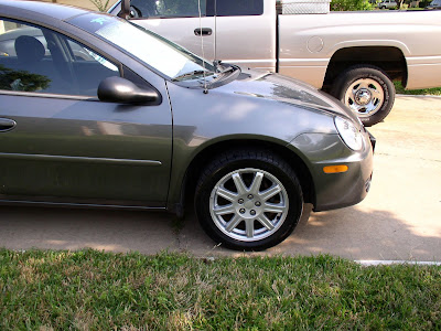

I was looking at another set of rims for winter tires. Would these PT cruisers rims fit on my vibe? http://brainerd.craigslist.org/pts/3268124527.html" onclick="window.open(this.href);return false;

Toyota Matrix Base/XR/XRS 2003-up (5x100mm / HPO / 12x1.5 Lug-nut / 54.06mm Bore)
Chrysler PT Cruiser 2000-up (5x100mm / HPO / 12x1.5 Lug-nut / 57.10mm Bore)
The bore is different, would I need an adapter for it? Does it look like they would be worth it?

You might want to verify a 6.5" rim width and that the HPO is about 39mm.
You should use hub rings - these thin rings aren't the easiest to find and you'll need the right lug nuts.
The price for the wheels is good if these are OK condition. good luck
