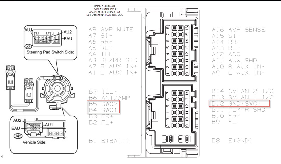

Upon research here is the designation for each of the 3 wire from the audio control pad to a TOYOTA head unit
Connector D3:
EAU (common/ground for steering wheel control)
AU2 (mode switch circuit)
AU1 (volume +/-, Seek +/- circuits)

Just got the head unit terminal diagram by sending a request from Delphi Automotive OEM website.
File too big.
I do not think is a huge deal i guess. Very few people interested in this project anyways.

This diagram is the most important piece of info for this whole project.

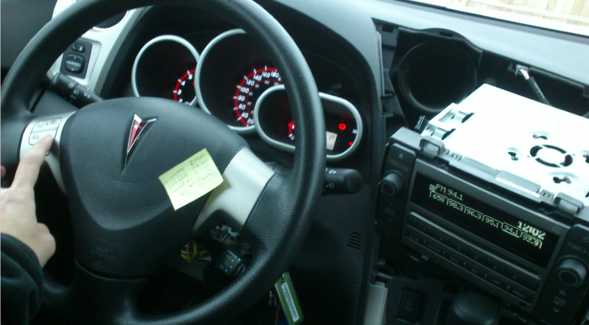

I can confirm ALL buttons on the horn pad should light up.
I had chosen to use the shifter light as my power source, since the connection plug is a bit over sized and allow me to (removed) in a little strand of wire inside easily, however you could tap from any illumination"green" wire as your 12 v power source to the clock spring pin #12 at J45
At first I still could not get the light to turn ON on my control pad despite my best effort.

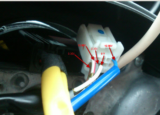

Then I do my little trouble shooting just before a huge snow storm caome past Sunday by using multi meter to measure if there is a 12 V power showing on the face of the clock spring pin.
I realized my terminal #12 at the clock spring wasn't insert all the way.
I should post a little picture to demonstrate the correct voltage I should get at Z3
The White-Red wire responsible for lighting, should be carrying 12V from J45. The sky blue wire is provide 12V to the horn. Both ground and grey wires are AU1 and AU2, respectively. They both carrying 0.36v signal from the head unit. The white wire beside it is the ground, carrying 0v unless pressing the buttons.

they do light up, no lie

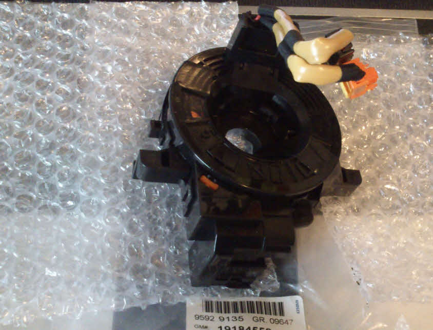

Current factory Clockspring
