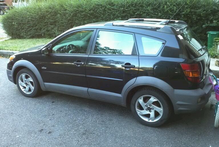

Picked up a loaded 03 vibe with a 1zz and a broken tranny...

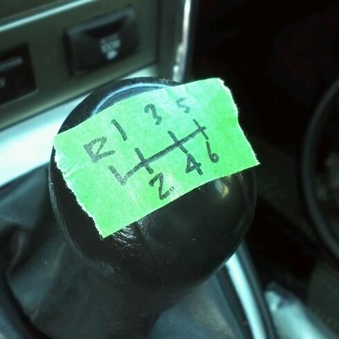

the DG needs a new transmission and luckily i have a friend with a supercharged 1zz wtih a c60 who blew his engine....so im pulling the engine/tranny and using the c60, exedy clutch and fidanza flywheel.
trying to make the black vibe an uber economical city driver

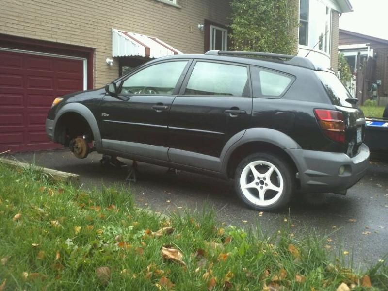

thus, i picked up some forged goodness today

Black vibe is a 1zz 5speed. Burgandy is a GT 6 speed.
Donor c60 (6speed) is coming from a friend with a TRD s/c'd 1zz matrix who already had a catastrophic 5speed failure.
I'm not doing an auto-manual swap...that's too much work.

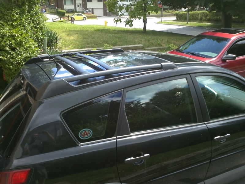

Popped off the roof rack from the doppleganger today for repainting

painting black I take it?

Mariachi wrote:painting black I take it?
Truck bed liner....so yes, black
