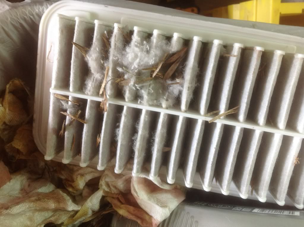

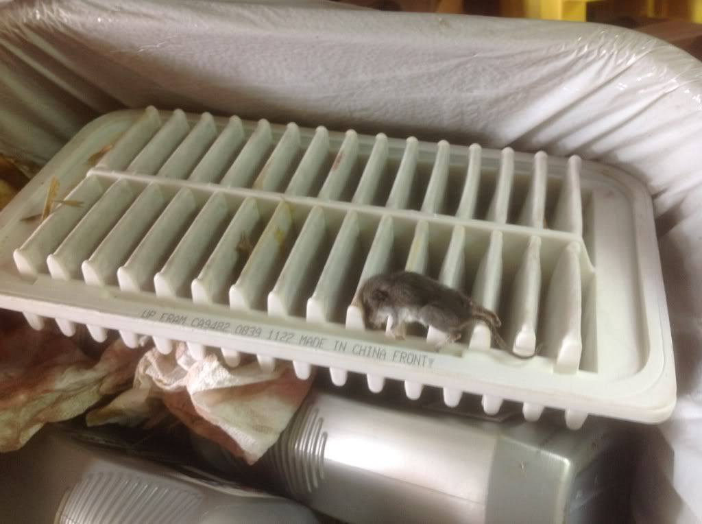

I popped the cover off and on top of the air filter lie two dead baby mice! How did they get on top?!?!?
Yes I know I said two but one fell off!
The air box was full of seed pods and two more dead mice! Ewwwww!
Turning the filter over, they chewed their way through the air filter!

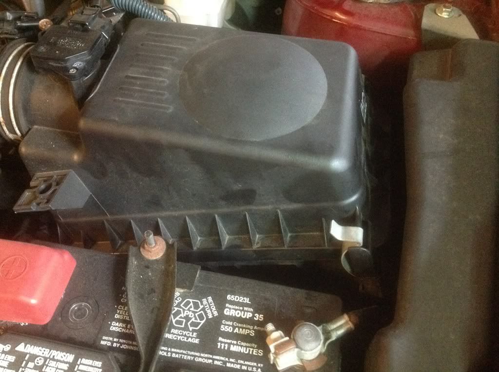

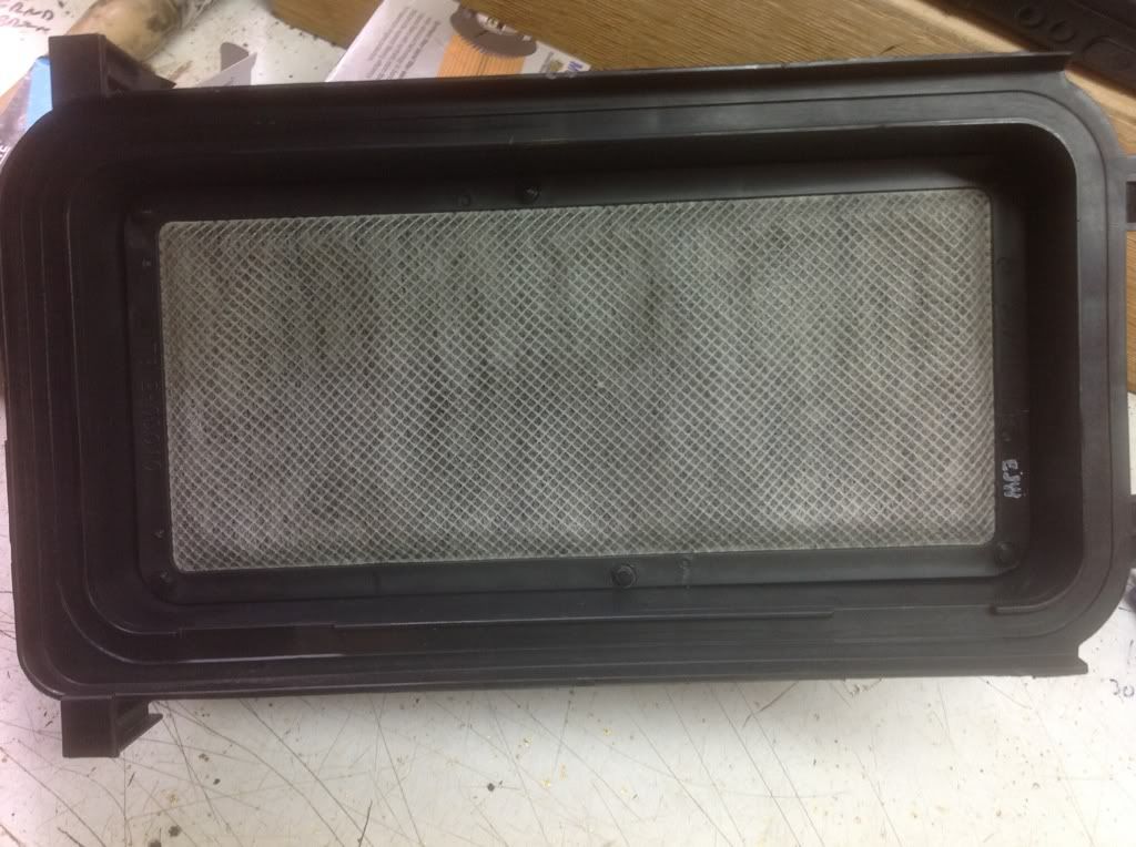

Fortunately the air box cover has a secondary filter before the MAF sensor so nothing made it into my intake and combustion chamber but a few stray small particles!

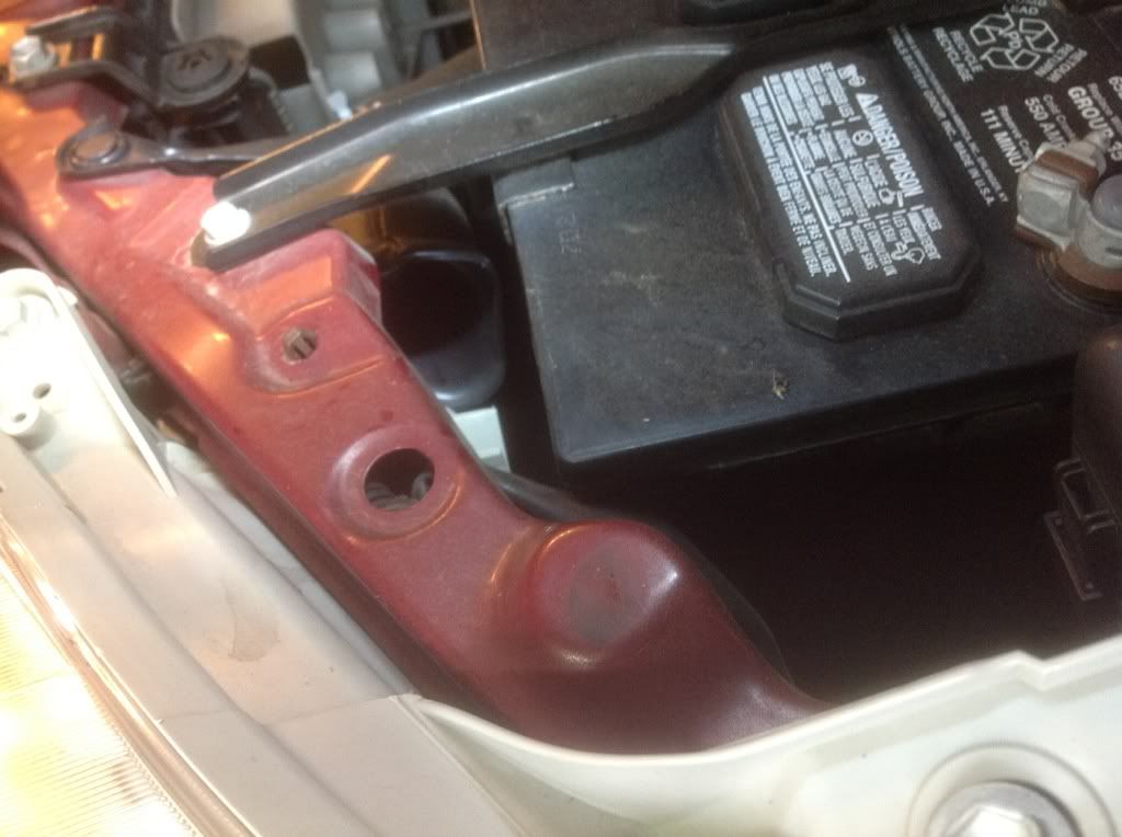

I guess the moral is that mice move in quickly! Be aware and check for them. They crawled through the intake pipe located in front of the battery.......
So, while I had it apart I cleaned the MAF sensor, cleaned things up, put in a new air filter and all is well. Also changed the cabin air filter, don't remember the last time I did that! :oops:
