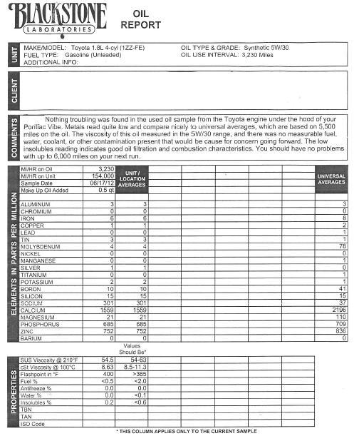

I know that these are posted over at bobistheoilguy.com but I wanted to start a thread on this topic here on genvibe. Thought people could add their oil analyses in one convenient location.
In that vein, I will start it off with my own oil analysis from Blackstone Laboratories. This one is not very interesting because I had it done at only about 3000 miles but it at least tells you that the 3000 mile oil change doesn't make sense for my driving conditions (about 2/3 city and 1/3 highway). They incorrectly put down that I was using synthetic oil when really I had a synthetic blend for that time.
Looking forward to seeing others analyses.

Thanks for posting your analyses blindman10. Did you run the engine at highway speeds for longer than 20 minutes before sampling? Is that the reason for the trace fuel showing up?
