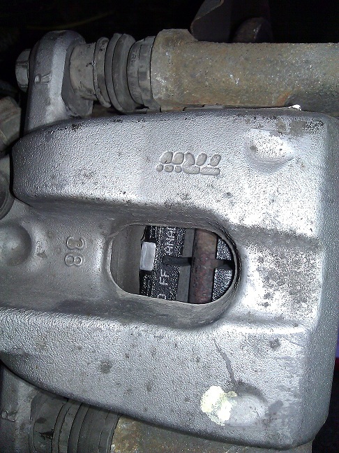

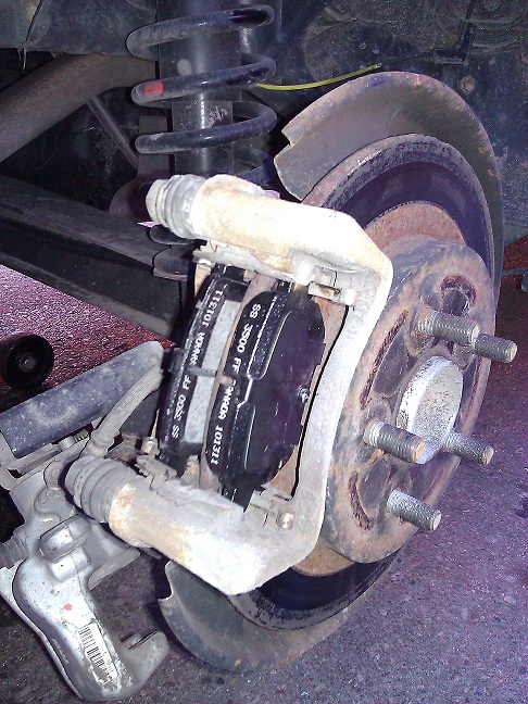

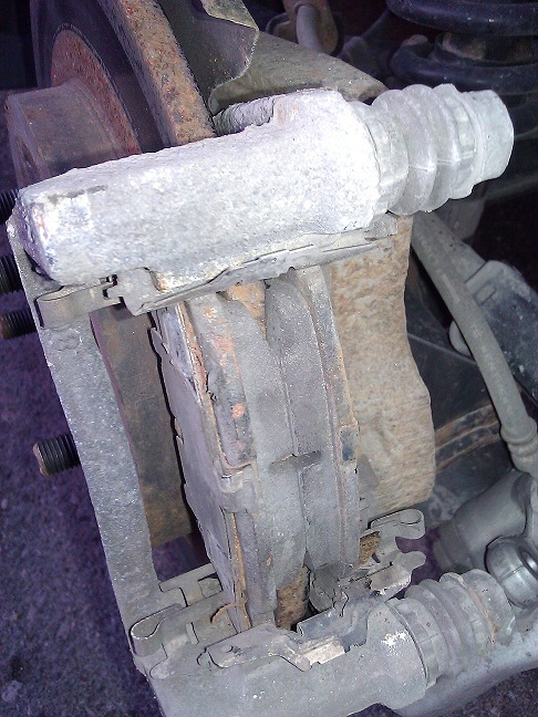

Some pic of the existing set up, I had to put the new pads, lost rear brakes because the top portion of the pads are touching when you press the brakes and the rotor is free to turn. Made an appointment with the GM dealer this week, let’s see what they have to say.
Thanks for all the suggestions!

Re: O9 base Vibe with GT rear brakes
Hmmm... definitely looks like a GT rear caliper to me :shock:. Here are a couple pictures of the rear brake setup on my 2009 GT for comparison...
Can't wait to hear what GM has to say about this. They'll probably blame it on Toyota :lol:!
Wow, that wear does look bad! I'm surprised it was not noticed during a tire rotation or something, but then again that amount of wear surface could appear normal if you had nothing to compare it to. I'm guessing the top part only occurred recently probably due to the pads touching at the top, but still having pressure on the bottom half.
Good luck with GM, I don't see how they could deny that something was done wrong on their end.
