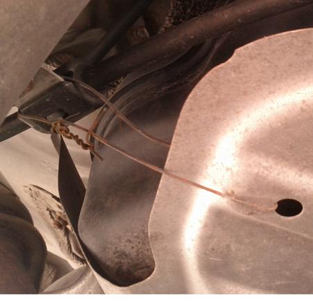

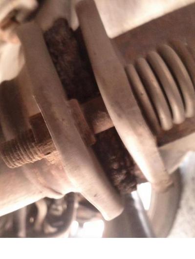

I have a 2006 Vibe base FWD manual transmission. There is a loud rattle/knocking, steady pace, constant. Coming from exhaust tubing on the rear right side, just inside the wheel. Its only noticeable with the windows down beside other cars or walls, the sound is there when the engine is idling and it seems to stop being noticeable above 3000 rpm. It can be heard prominently while standing beside it. It has gotten progressively louder over the last week, so has the volume of the exhaust. Recently (a few weeks ago) got new spark plugs put in and had e-brake cables replaced. I fear i'll need a new muffler or catalytic converter, but funds are tight. Any help is appreciated! Thanks

Loose heat shield?

I went out and took some pictures, here's what I see:
Feel like this isn't right... (located right side in front of rear wheel well)
I think this could be the culprit, its very worn out (located right side by the rear wheel)
Any thoughts? parts or approx costs?

drive nut nailed it
The first photo is part of your heat shield, it's missing a bolt or two
The second photo is an expansion point in your exhaust, This photo is normal and doesn't need any work to it unless it's leaking. Which judging from this photo it is not. SO leave it alone, ditch the coat hanger on the exhaust manifold heat shield and replace the coat hanger with actual bolts and the noise should go away

Im going to bring it into a shop this week, i think it is just the heat shield rattling but the exhaust itself it getting really loud, and when slowing down it makes a kind of gurgling sound

problem solved, gasket was ok, but the exhaust tube itself had a hole right near the gasket, then it broke off all together, soo loud, got the spring joint thing replaced with a flex joint, no rattles from heat shield any more!
