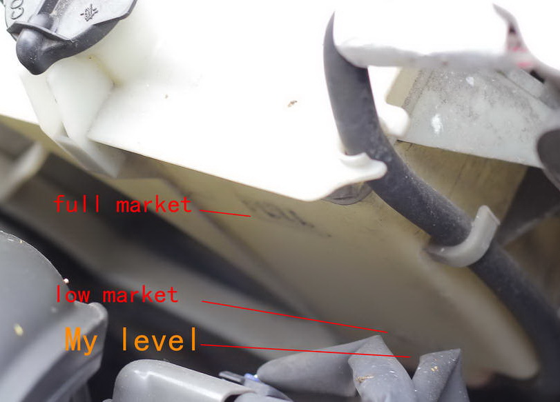

hi guys! I just bought a used VIBE from a GM dealership 2 month ago. my Vibe was made in 2004. and 74000KM now.I don't know how the previous owner did the maintenance before.when I bought it. I noticed the coolant level is very low in the overflow reservoir.but the dealer said to me "it's ok" . I attach the picture on the following

(1) I already drove it for 7500KM, and I noticed the level of coolant is stable.So it mean there is no leak in the cool system. but why the coolant level is so low? is it normal?
(2) if it's abnomal ,does it mean the previous owner didn't maintenance it regularly, so the water has evaporated these year to make it low?

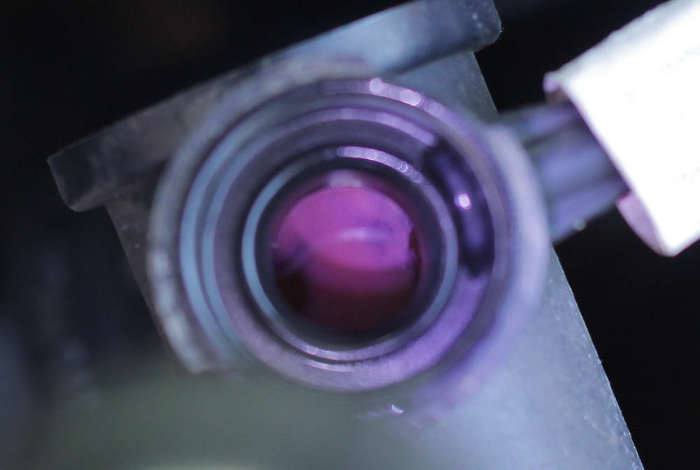

(3) I open the radiator cap, the level there is ok. but the pink coolant seems to separate to two layers, top is transparent liquid and bottom is pink sediment. is it normal or mean the coolant is overdue?

I would just do a drain and fill, especially if using premixed. Then in a few weeks do another drain and fill. Then, possibly do another drain and fill next year and not worry for the next three years or so. I would probably use Zerex Asian P-HOAT (POAT) premix. Napa carries it. If I could not find any Zerex Asian, I would probably spend the money on the Toyota super long life pink premix. Motorcraft has a deep green Asian formula that is a Phosphate (P-Hoat) which would probably work too. Another interesting coolant is Peak Global that comes in premix and possibly full strength, but am not 100% comfortable with it.
If you use full strength, use distilled water for mixing. If you feel the need to flush, just fill up with distilled water and run for a few minutes, then drain in a pan for proper disposal. The problem with flushing when using a premix is dilution of the coolant since you cannot get all the water out.
This is how I usually do a coolant change. It might not be correct, and I might make things more difficult than it needs to be. Do a search for the proper procedures. I have not actually done a change on a Vibe yet. Hopefully someone will chime in. When I do, I will just drain and fill and use premix. Much less hassle:
If using a full strength, fill first with the right amount of coolant, then top with distilled. Burp the hoses to get air out and top off. Mix with right ratio in overflow. Start car and let run, burp, and top off at radiator. Might take a few minutes for thermostat to open. When it does, the level usually drops and at that point heater core hoses will be getting hot and heat will come out of the vents when turning on heater. Be careful. When you pretty much have used up the right amount of distilled water into radiator, Turn off engine and put radiator cap on. If you did a distilled water flush, there would already be distilled water left over in the system that you did not get all the way out so you might not be able to use all the measured distilled water. This is why I always put in antifreeze first, instead of premixing and trying to fill up. Let run for a while and build up pressure, checking overflow tank and top off. Let cool down and carefully take off radiator cap, stopping at first "click" using a towel if not sure if all the way cooled down. Then proceed in removing the cap. Burp and top off if needed. but be careful not to squeeze too hard and splash coolant out. Recheck a couple times over the next few days.
Not sure off hand how much the coolant reservoir holds at the cold line. A good guesstimate or actually taking it out and measuring it might come in handy, since I think the total coolant capacity has that figured into the equation.
I believe there is an engine drain petcock that would help in getting most of the coolant and distilled water out. Most people probably just disconnect the lower hose instead of risking damage to the radiator drain petcock, but I would probably do both.

but I still wonder that should I frush and refill the coolant system?
easy thing for me is just top up it.
does anyone check the radiator cape and notice the pink sediment? it mean the coolant is ovedue?
