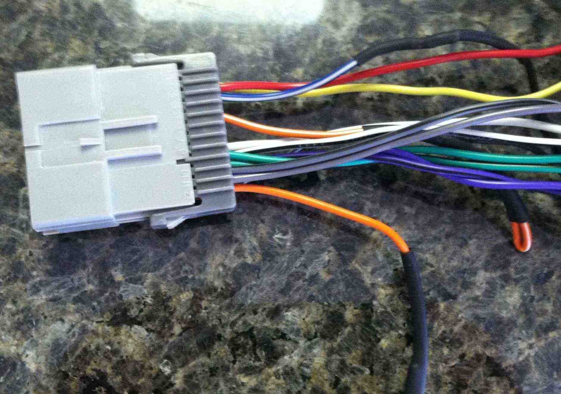

New setup which uses no blue box. The connector to car harness was soldered directly to head unit harness.

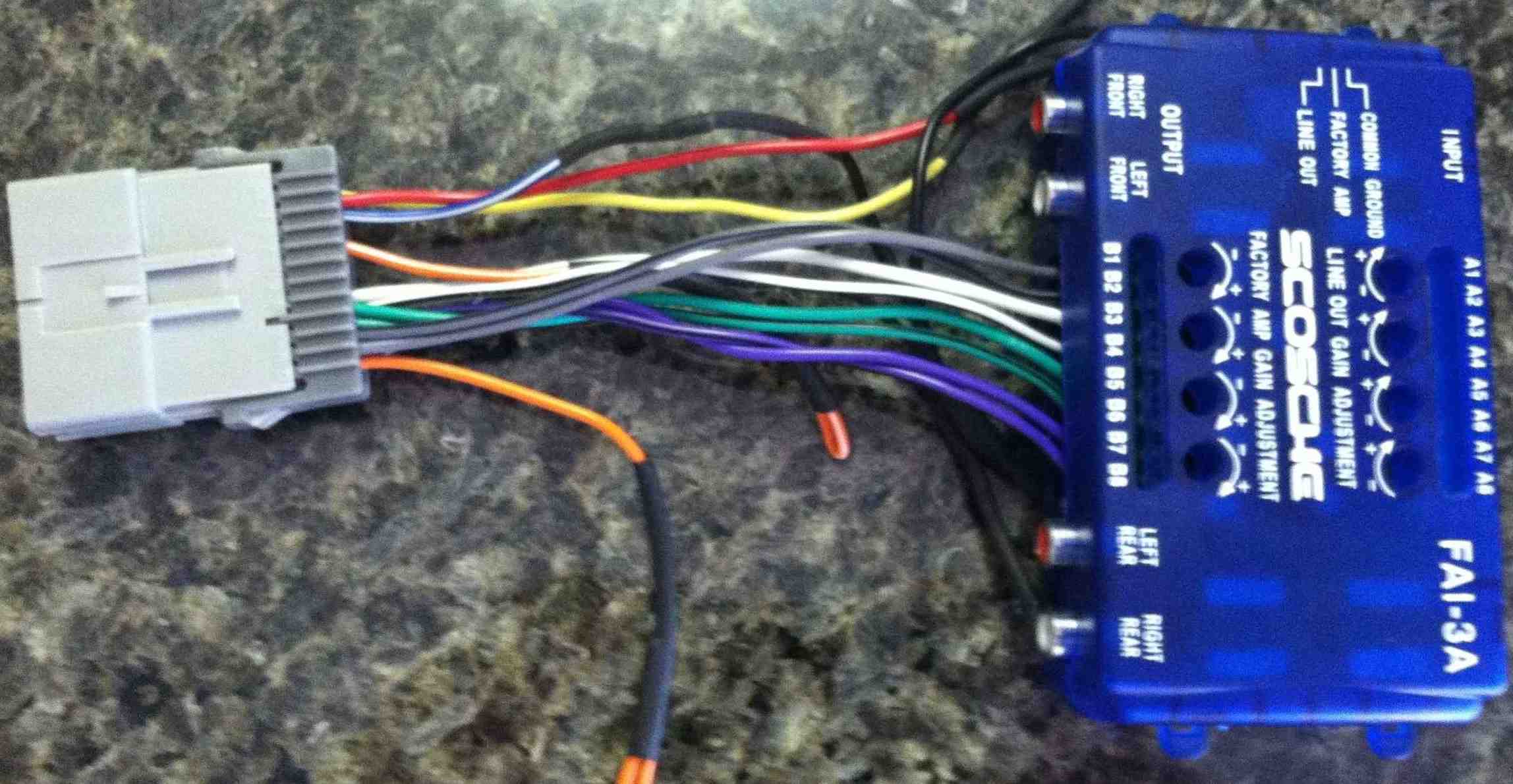

Old setup with connector to car harness and blue Scosche box
