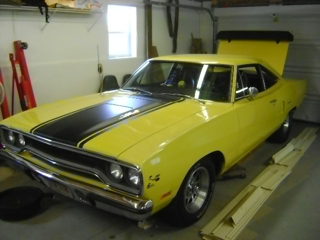

1970 Road runner 440 Six Pack - 3 2-bbl Holleys, Tremec 5-spd, hydraulic clutch.

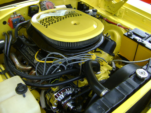

This is the heart of the beast. Yes, I get a stupid smile on my face every time I pull the cover off the car and look at it... and every time I hit the GO pedal!
Engine 2.jpg (137.35 KiB) Viewed 2525 times

VinnytheVibe wrote:
Dude.... Wheres the drool smiley? The roadrunner looks suweet
