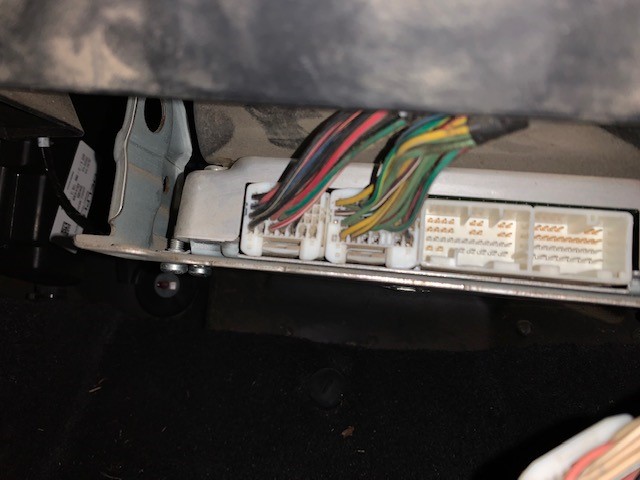

Define computer? There are alot of modules that have some "brains" but the main ECU (ECM or PCM) is under the glove box. There's a couple plastic "rivets" under the glove box that will allow access to the conectors. You need to remove the glove box to access the 2 scews that hold it in place.

Here is mine right under the glove compartment.
