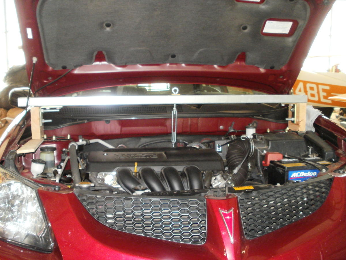

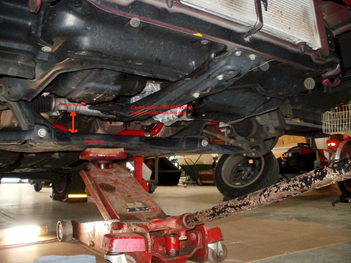

Well, to add to this, the Hotchkis instructions are a little overkill. There is no need to disconnect the forward/center motor mount or the center support from the radiator back to the subframe. Leave the front end of this brace connected.I made a motor support from a piece of unistrut and a couple of sections of 2x6 about 5 inches long and two Unistrut L brackets and bolts. All of this I had on hand, and it took about an hour. I positioned it on the shock towers and used a turnbuckle attached to the unistut to hook to the motor lift bracket on the back side of the motor. This allowed me to leave the aft/center motor mount connected to the transaxle and drop the subframe down.I left the ball joints and lower arms attached to the spindles, as it helped keep the subframe from going anywhere, I just lowered it with the jack and after the bar was changed out and re secured, I raised it back up and the three studs on the motor mount hit the holes and came right thru, perfect alignment.The two LH steering rack to subframe bolts, especially the forward one, are very difficult to access and a real pain to reinstall. I used about three foot of 3/8 drive extension and a 9/16 flex socket to run the forward LH bolt down and then was able to get a box end wrench on it just enough to tighten it the last little bit.Attached it a pic of the motor support I made. Other posts that follow will have other pics.Charles

Attached is a view from the front of the subframe after I lowered it and positioned the new sway bar. The steering rack is suspended to the exhaust manifold with some wire on the passenger side. Note how it is in "thin air" about 4 inches above the subframe.

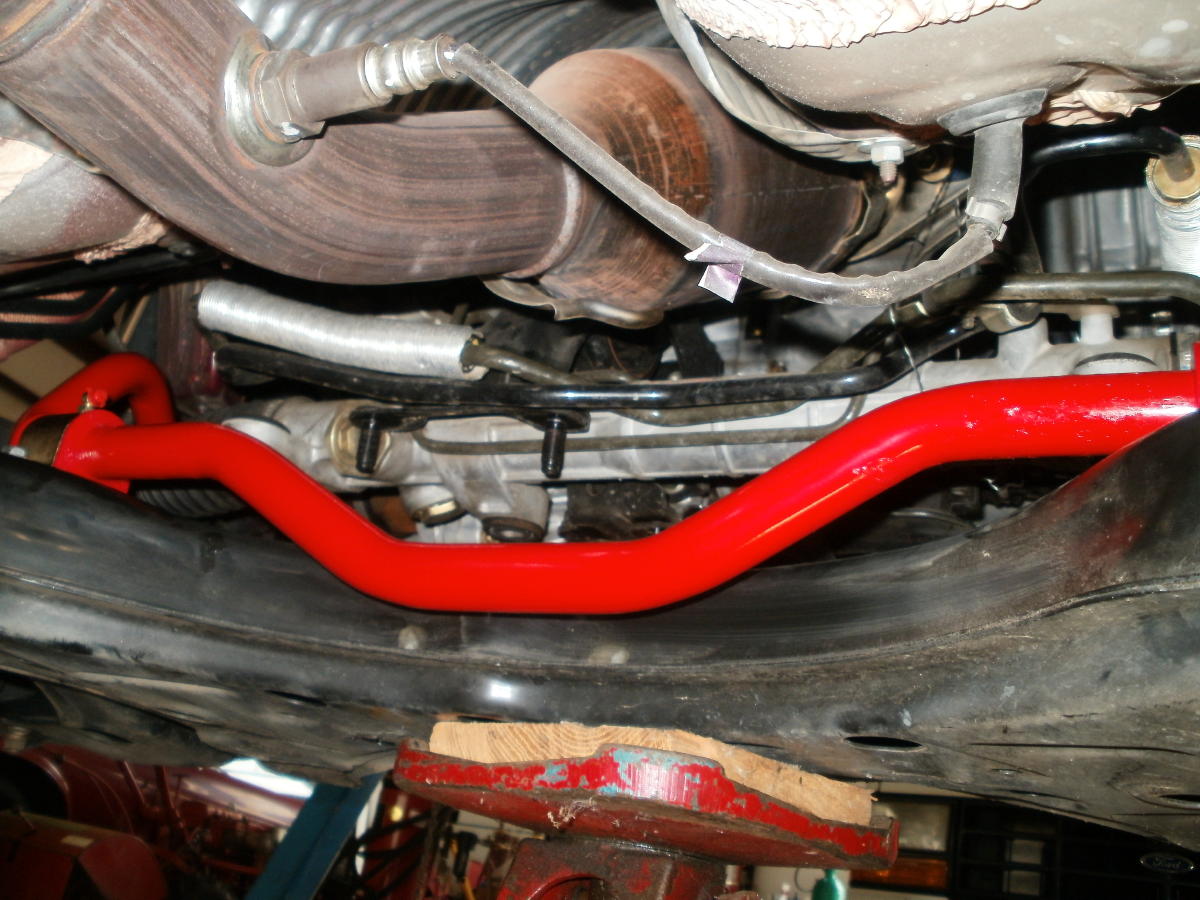

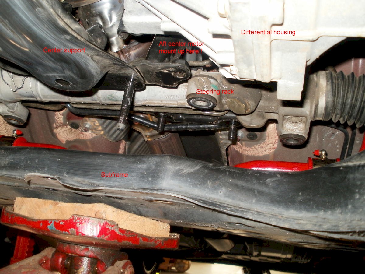

Here is a close up view of the subframe and steering rack from the front. You can see the new sway bar (very red) and I have labeled the steering rack and differential and aft motor mount. The steering rack is secured with bolts installed from the top, down into welded in nuts inside of the subframe.

This is a reverse of the view above. Here we are looking up and forward. You can see the steering rack the aft motor mount and the O2 sensor and exhaust pipe going up to the manifold. Sway bar is bolted in place and it is time to raise the subframe back into place.

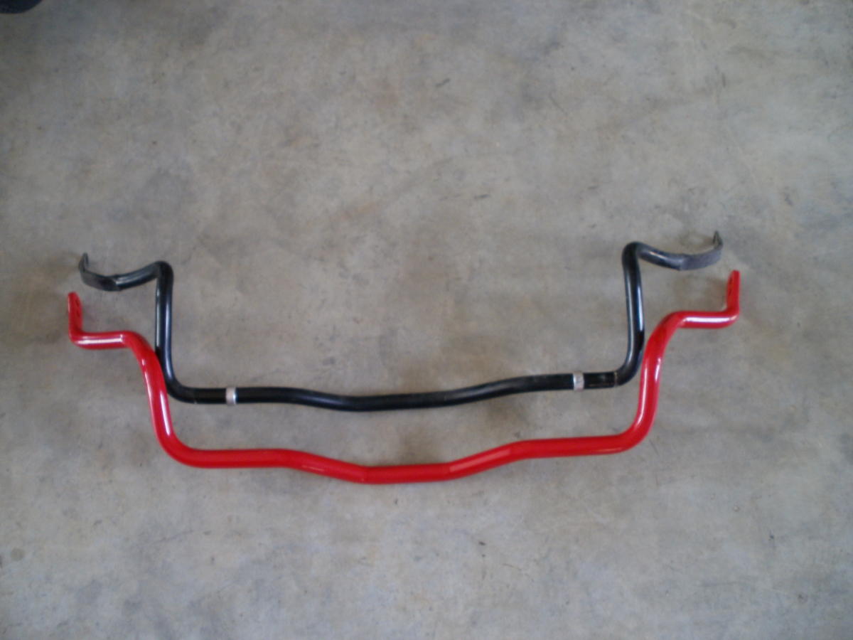

Comparison view of old and new front sway bars. The new bar is bent differently. With the vehicle off the ground, the steering rack end boots actually rub the bar slightly when you operate the steering. On the ground, there is a fair amount of clearance however.

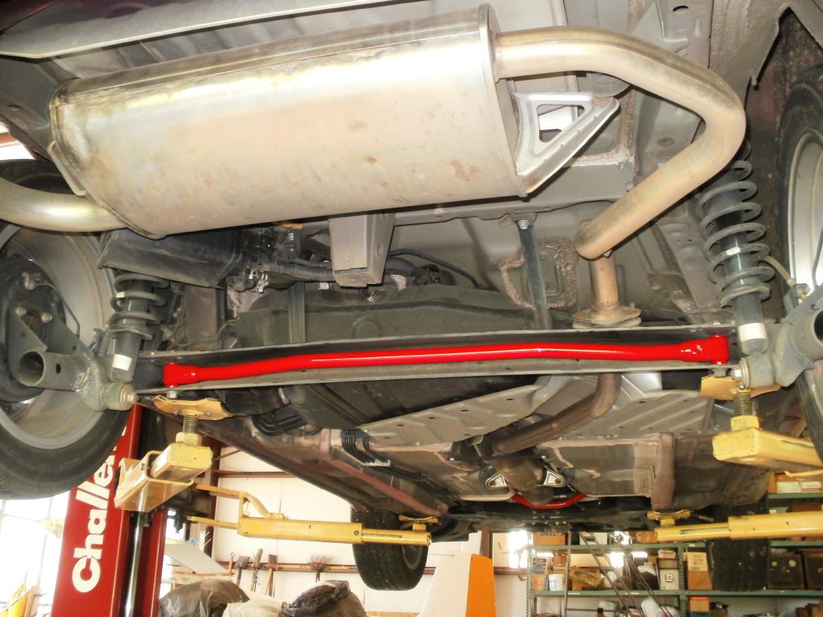

Rear sway bar installed. Not much to see. The rear axle design is incredible to say the least. Two trailing arms, pivoting on rubber bushings, and connected near the pivot point by a V shaped piece of steel, V opening facing aft. Independent movement of the rear wheels twists this V shaped piece of metal constantly. The sway bar is installed inside of it and absorbs much of the twisting force. Hotchkis instructions show the bolts with heads up, but the factory had installed mine with heads down, which I did when I reinstalled them, using locktite on the bolts. Torque is 150 lb/ft and it needs to be properly torqued to keep it from coming loose.

Nice job! Big difference right. I know when I put mine on it was worlds apart.
old and new front sway bars.jpg (82.97 KiB) Viewed 11735 times
