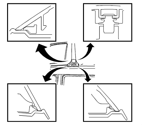

I scanned and created two PDF files of the Roof rack and the Roof Trim cover from the Service Manual. See next post for the roof trim.Here is the 09 Roof Rack attached here:
Attached files 09roofrack.pdf (80.3 KB)
ParknVibe
Posts: 563
Re: Pictures of a 2009 roof rack? (onegriggabyte)
Post by ParknVibe »
Here is the Roof trim (09 roof trim. PDF) pages from the 2009 service manual:Because the Book is really thick, the pages have black shading along the edges
Attached files 09RoofTrim.pdf (70.9 KB)

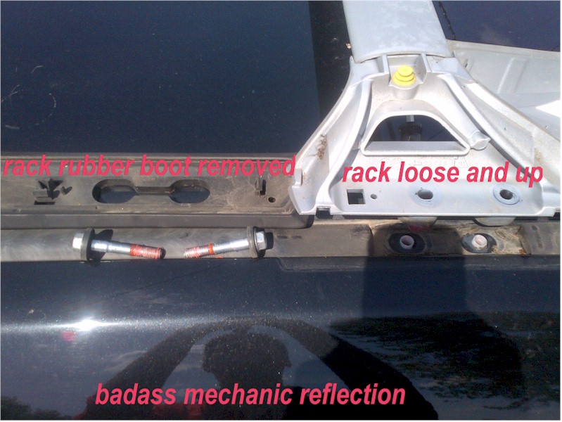

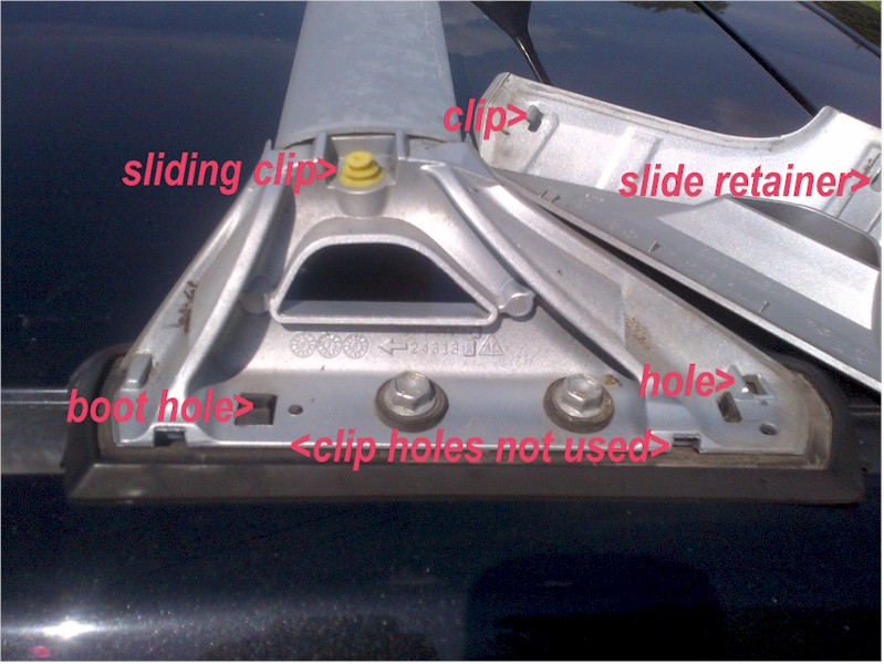

not to resurrect and dead thread, but here is the info needed that wasn't clear for those who want to get rid or replace their rack.
The clip retainers are NOT installed under the roof racks that come from the factory, so if you want to use the stock filler clips, you need to order them or find another way to keep them in. The only thing under the rack is a thin film gasket. The bolts can be reused.
>Upper retainer - either side: #19184014 - MSRP: $7.95 / GMPD: $4.78
>Lower retainer - either side: #19184016 - MSRP: $15.44 / GMPD: $9.29
The cover clips are thin plastic, unlike the rubber roof rail. And you will have an outline of the larger rack boot on your paint, but clay compound will clean it up.
Removing the rack is fairly easy.
The outer shell is attached by 2 clips pointing down on the front and rear of the rack base, and one sliding clip in the center top(see diagram, although it is likely just as confusing)
The entire rack is held on by two M12 bolts on each side; they have plenty of locktite on them so they might be tight to break loose.
The bolts go through roof and there is an interior loose bracket underneath - carriage bolts or similar are not welded to the roof. If you take off the rack and are not using the oem replacement clips, you have to reinstall the bolts or the frame clip underneath the roof will rattle as the bolts no longer hold it in place.
I decided to just use some black silicone, a large dab on each bolt head that contacts the cover, and a little thin strip on the leading edge. Nothing is holding in the rest of the rubber roof rails, they are just pushed into the groove and loose to allow water to drain, so this may not work in extreme situations, like if you blast it with a pressure washer.
FWIW: The clips retainers and plastic covers seem like a silly solution, if the default model has no roof rack. A lot of diff parts for a std config. Another chunk of rubber with inserts to fit in the bolts wholes would look a whole lot better.

IF you remove the roof rack, you need the covers
HOWEVER, the metal bracket piece underneath that holds the covers on doesn't come with the cars that have roof racks.
So you either have to buy those metal clips, or like I noted in my post, I used some window black silicone to tack them on.
The bolts underneath almost touch the covers, so a big dab of silicone on the bolt heads with keep the covers on.
You can't quite tell with the roof rack on, but the long rubber strip along the roof rail is just sitting in there; you can probably pull on it a bit at the ends to see this, so you need something that will hold the thin plastic clips on
Those metal clips are not cheap so I tried it without and it worked
Maybe you can arrange a swap with someone and get their roof covers and brackets

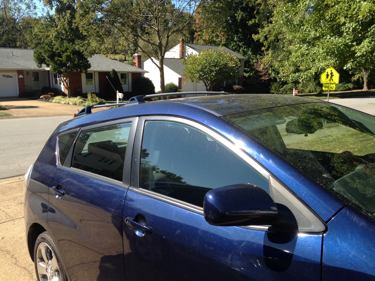

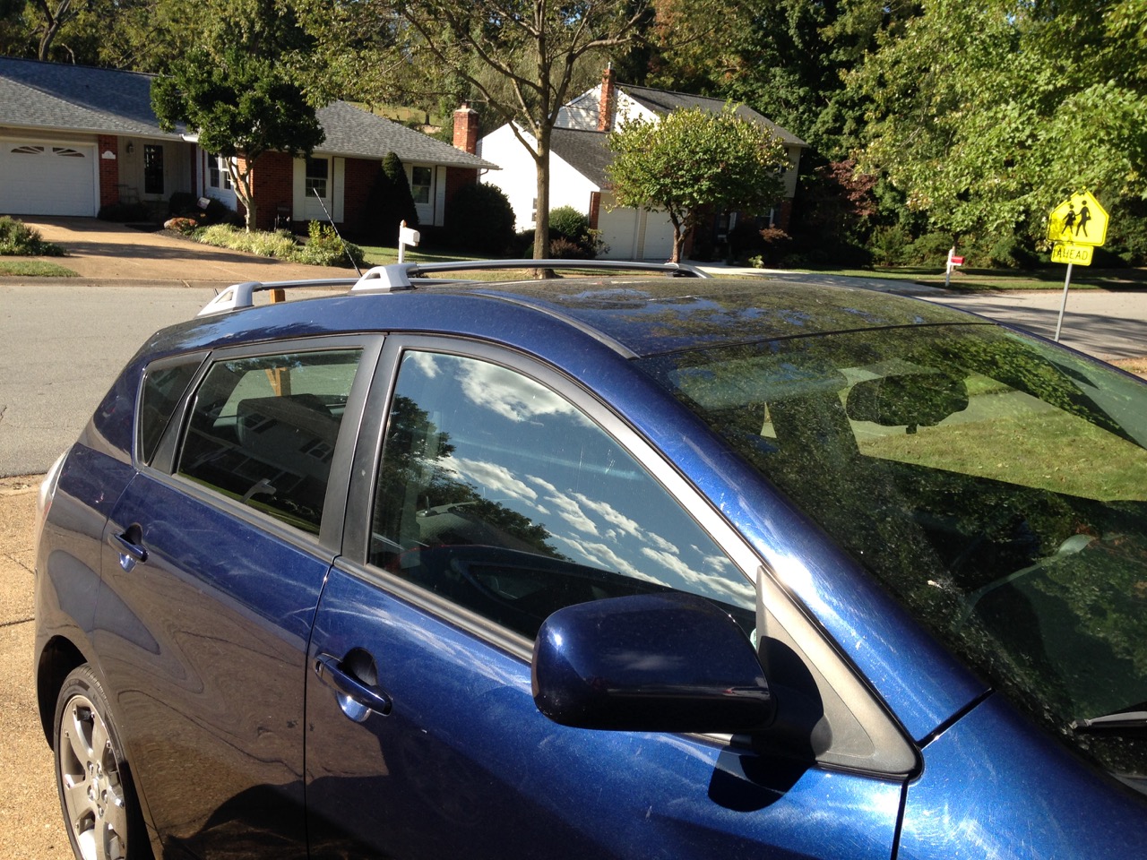

Alternative solution
Post by ralphgonz »
This thread has been very helpful, thank you to all who posted!
I too was put off by the cheesy look of the 2009/2010 Vibe roof rack. I also noticed that many cars (including my wife's minivan) have black uprights with naked aluminum crossbars, and realized that it is exactly the aluminum-look plastic boots that make my roof rack look cheesy.
So the simple/cheap solution is to pop the plastic boots off (you need a screwdriver to pop the front and back off, then pull toward you to get it off the sliding clip), sand them down, and spray paint black. I used a can of black satin Rust-oleum Universal paint-and-primer-in-one that I found in the garage. Here are before/after photos. Most people might not notice, but to me it totally transforms the look!
Next step is to get a quote on sandblasting/powder coating the chrome wheel covers black!
