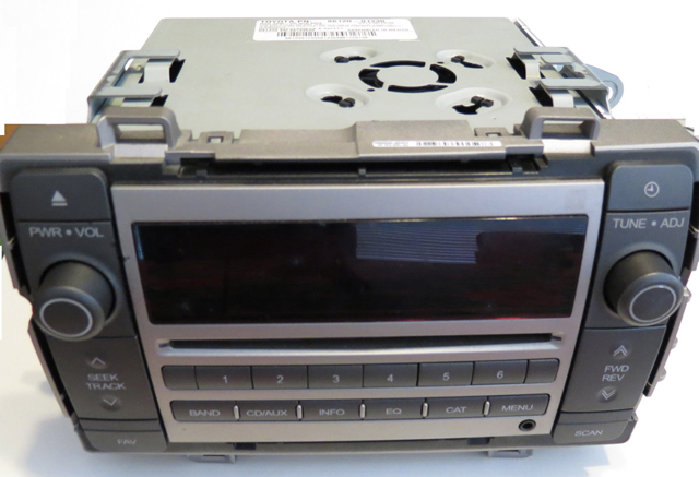

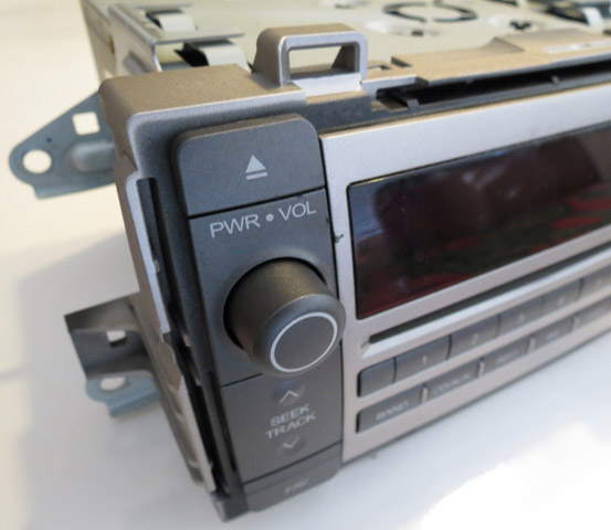

Fixed my 2009 Gt broken radio knob!
Post by DuluthVibe2009 »
As many 2009-2010 Vibe owners know, the volume/tune knobs on the radios have been a problem. If you are under warranty you can get it fixed (refurbed radio under warranty).However, if your like me you are out of warranty. The knobs do not simply pull off like most cars. The faceplate holds the knobs in place. So, I decided to pick up a cheap used radio from a 2009 vibe off of ebay and try and fix it myself. My original radio was in better shape than the used one hence the reason I didn't just put the used radio in the car. All in all it was far easier than I thought it would be!First, be very careful. The job includes removing a number of small screws on the radio itself and trust me, there tiny! I won't go into detail on removing the radio from the car as it's pretty easy. Pop off the trim panel (there are no screws), unhook the hazard button and the passenger seat belt light (one wire on each. They pop of easy). Then there are four screws holding the radio in. After that there is the antenna wire and two harness sets going in the back of the radio. The antenna lead is a bit of a push in and pull kinda' thing. Do be careful with the top of the trim panel! The top hook is kind of "J" shaped and could break easy. You need to lift up on the bottom of the trim and "lift and pull".Ok, now the fun begins:-) On the sides of the radio there are four screws. Simply remove them. After that there are two clips on the top and two more on the bottom of the front bezel as it attaches to the rest of the radio. Be careful and pry the front face plate off. As you pull the front face off you will see one wire attaching the face to the radio. This just pops off. Now the front face should be free of the rest of the radio. On the back side of the face plate you will see about 12 very tiny screws holding the electrical board in. These are a a pain to remove and you are dealing with the board so take you time and be careful. Once these are out the board (witch is what the knobs are attached to) will simply pop out. At this point you can simply take off the broken knob and replace it with one from a used radio that you take apart in the same fashion. The volume and tune knobs are the same so if you buy a used radio you will have a spare knob. When putting the face plate back together you need to make sure that the four plastic "plungers" on the backside of the seek/scan buttons stay in place. These like to fall out.At this point reverse the process and enjoy your fixed radio! I found the plastic inside the knob was broken causing the knob to just spin. No loose glue as many have speculated. If I can figure out how, I will be attaching a series of photos that I hope explain all of this. It took me about an hour to fix mine. Having now done it once, I could probably do it all again in about a half hour from beginning to end. It sounds harder than it is. If you can get a used radio for cheap ($60 in my case) it sure beats paying a dealer to fix it or buying a brand new radio if your out of warranty. Hope this helps!
DuluthVibe2009
Posts: 11
Joined: Mon Sep 20, 2010 8:38 am
Re: Fixed my 2009 Gt broken radio knob! (DuluthVibe2009)
Another photo...
DuluthVibe2009
Posts: 11
photo 3
DuluthVibe2009
Posts: 11
photo 4

photo 7. The "plungers" on the back side of the seek/scan buttons.
DuluthVibe2009
Posts: 11
photo 8. The inside of the broken knob.
Nice writeup ! I have yet to experience this problem, but I know it will help out many others here that have.Just out of curiousity, do you think it would be possible to just put some adhesive on the knobs and get them to work properly? This would obviously be a much cheaper fix than buying a used radio.

You probably could try glue. My only worry about that would be making a mess out of the pegs the knobs go on to then having an issue down the road. But it could be worth a try.
Re: (DuluthVibe2009)
I guess if I have this problem down the road, I will try some glue first before getting a used radio, but definitely a great writeup for sure . Thanks again !

How strange that the knobs break this way - the radio knob has to be about the most un-stressed part in the entire car!
Re: (Kincaid)
Quote, originally posted by Kincaid »The radio knob has to be about the most un-stressed part in the entire car!You've obviously never seen an irate wife hammering on the buttons and knobs when her horribly scratched cd starts skipping...

I had my radio replaced because of the Volume knob. What do you thing about removing a good radio knob and reinforcing it with Epoxy inside the shell of the knob? Being that you had a look inside the knob and how it is fitted to the control, can this be done?Thank you
DuluthVibe2009
Posts: 11
It could be done. However, if you look at your knob at night you will notice how the light kind of shines through. The light emits from behind the knob. Putting to much glue or anything else in there might block the light. But in terms of it just reinforcing the knob it would probably work.

I used 5 minute epoxy to fasten the broken knob back onto the post(very carefully). I followed the steps and got the radio out, and the broken knob out of there. Then I filled the bottom half of the knob with quick setting epoxy and held the knob straight on the post until the glue set. I had to hold the entire assembly upside down until the glue set, so the glue didn't drain down onto the radio. It sounds a little dangerous, but it worked. Just be careful with the epoxy.The hardest part was getting those 12 little screws out of that circuit board. I had no socket small enough, so I used a good pair of thin, flat blade pliers.

GM now has a replacement knob. Just got it from where I bought car. Cost 6.95. Have not replaced yet; just found this site. Dealership want 106.00 for labor to replace.

I bought several. I was thinking about sanding/dremelling the lip of the knob so that it can be removed without removing the whole radio to do so. At $6 a knob at my local dealer, I can spare one or two to try

I just fixed my wife's 2009 Vibe following these instructions. I bought knob GM# 19204643 from my Pontiac dealer. Cost 6.95. Instructions are good. I would add a couple of hints. 1) the 12 screws on the back plate are six sided. I thank it takes a 3mm socket (most sets only go to 4mm) I used pliers to remove when I couldn't find the right socket in my town(small)a mini wrench set similar to the mini screwdriver set would work. When I put back the 12 screws I had computer screws and replaced the 12 screws with philliphead screws, much quicker. 2) When you are pulling the wire off the the face plate (red/black wire) be extremely careful. It did not come off easy; and when I pulled with enough force, it bent the prongs ( the plug slipped on). When I straighten them, they broke off!! Doomed I thought! Soldered them back on; it worked.3) When you put the radio back in, make sure that the to wires that plug to the grey trim are on top of the radio so you can get to them easy. If you don't, you have to take the radio out again to get to the wires. Should be a 30 min job if nothing goes wrong. If not 1/2 a day like me.

Hi Vibe owners, just did this repair today, not a bad job, those dam screws that hold on the board really stink. Once those were out and back in the rest of the job is easy. I did the 6.95 deal too, I bought 2 just in case, I have an extra, don't know how long these will be available. If this ever happens to you and ya can't find a knob then e-mail me or pm me.----Frank
Re: Fixed my 2009 Gt broken radio knob! (frankiemenz)
First off, thanks for this thread! The 2010 Vibe I just bought has a broken knob, and if my dealer can't fix it under warranty, I'll do it myself. I called to check on the part, and the former Pontiac dealer did not have one, but they told me the Chevy dealer down the street had 13 of them in stock! Must be a pretty common item to break, and obviously Chevys use the same part.

I did the repair and it was not that fun. I had a tuff time getting the wire off the face plate and was careful but the prongs still broke off, so you may have a soldering job included in the repair. I found the other good working button was also getting ready to fail, so glad I got two knobs. I think I am going to upgrade and dump this unit, this knob thing really sucks.

I finally got around to fixing my radio knob, and only spent like 15 min on it! Tools I used: I took journeyforce's idea on here and cut off the flat retaining tab on the back of the new knob with some wire cutters and used a piece of sandpaper to smooth down the edge so it is pretty flush with the rest of the knob. Then I took to removing the broken knob. First I tried my wire cutters again, but was not getting far, so I used my coping saw to cut the face of the knob across in a couple of places as you can see in the pic below. It made a bit of a mess on the console, but that will be cleaned up later. I then used the wire cutters to cut and remove the top part of the knob in the pic above. I had to cut and pull and break it a bit, but it came free. Then I cut away at the bottom part that was left in the radio, chipping away pieces of the plastic, being careful not to damage the face of the radio. Once I got much of the bottom of the knob removed on one side, I was able to grab it with the wire cutters again, and break the plastic on the cut down side, through the remainder of the knob. Then I was able to pull it out of the opening. Next I had to remove the metal ring that holds the knob to the radio shaft. That took the wire cutters again on the metal ring and I was able to pull it off the shaft. It took a bit of force, but it finally came off. Then the new knob was able to slide right in place.Now if it breaks again, the knob will just fall off the shaft. And I can easily cut down a new knob and install it after removing the metal band from the shaft again.

After disassembling the head unit and knowing the knobs are going to fail again, I believe for me, this would have been a better way to go, all because of that stupid flange on the back of the knob. Seeing your fix though I wonder if a Dremel tool with a cutting blade would have helped.Kenwood KDC-X995

Dear Mr. TRB:Did you say that you cut out and removed the old knob without removing the radio or disassemble the face?Do you have a good picture of a new knob as viewed from the backside? (ie: looking into the hole of the knob) I like to see how it was molded to outside face. Also where were the breaking points of the plastic as was when it broke?I like your idea of removing the knob's flange. Does the backlighting bleed through around the knob with the flange removed?
Thanks trb - I like this direct approach. My power knob is spinning 95% of the time and I know it's gioing to need attention right away. Or whenever it totally fails. I'll try and follow up after I do it, which will certainly wait until I get down to the Chevy dealer for a replacement, Pontiac RIP. Did you have any real difficulty in the final breaking and removal of the old knob?
Sorry ParknVibe, missed your questions. I basically cut the curved lip so it is flush and the side of the knob is flat. Someone else on here suggested that idea. And yes, the backlighting does show through around the knob a bit, but it does not bother me. If I replace it again, I will use my belt sander to sand away the curved lip until it will just barely clear the radio opening. That will reduce the backlighting a bit.
And as for removing the old knob, I just had to keep cutting away at it with my cutters until I got it down far enough that I could use the needle nose pliers to break it. Main thing is to be careful and not pry against the radio face. After I finished it up I noticed that I did put a couple of nicks in the radio face, but nothing major.

I used this technique and fixed mine (2009 Vibe) today. The antenna wire was hard to get off with your hands, I had to use pliers to pull it off. I thought if I get another defective weak part it will break, and I like epoxy, so I went that route. I think the repair could be stronger than an original part that has proven itself too weak. So far so good. Loctite set in less than 5 min., you have very little time to work it.
Thanks to deluth for the great pics, and to Gadabout for a good idea!!!

[quote="DuluthVibe2009"]As many 2009-2010 Vibe owners know, the volume/tune knobs on the radios have been a problem. ...
DuluthVibe2009 -- YOU ROCK!!! That is the most awesome and useful post!! Thank you SO much!
I followed these instructions and the fix was super easy.
Those 12 screws on the printed circuit board came off pretty easily with a hex driver I had so it was not too bad.
I did mess up in that the replacement knobs came with the metal band around the knob shaft, and when replacing them, I accidentally left the metal band on from the previous knob on. So when I put it all back together, the knobs did not slide down low enough onto the shaft. Ooops. Easily fixed though.
