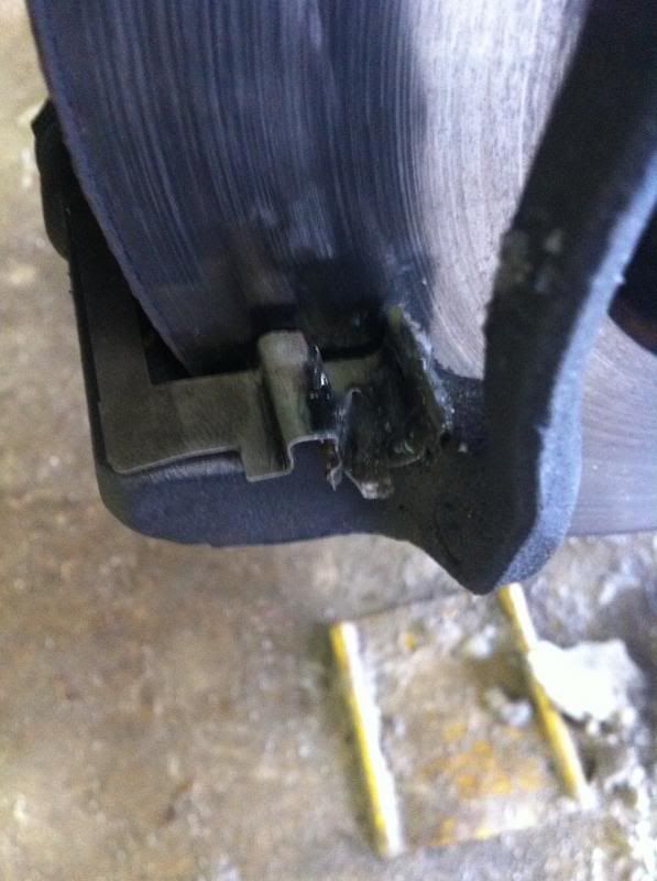

Is this the same noise you guys had?
porkercon
Posts: 5
Joined: Fri Dec 13, 2013 2:30 pm
Re: Front Passenger Creaking while braking.....?
Post by porkercon »
I fixed it. I did get new pads and the rotors lathed down about 3 months ago. I greased up the pads and pad holders today and the noise has gone away. Where the pads contacted the pad holders it was bare. Here are some pictures.

Post by Water boy »
I've always cleaned and lubed all pad contacting points. I don't like having to go back into a job.
