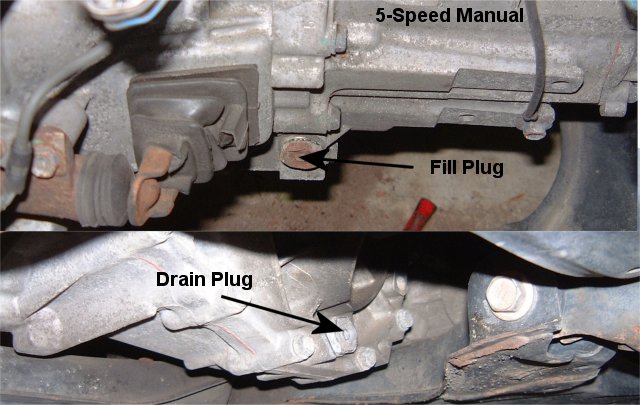

Hi vibe-04There is a 24mm drain plug and either a 10mm hex fill plug or it's some standard full plug. The 03's aparently had a 14mm standard bolt type plug.Search for "Manual Transmission Drain". I found my info on newcelical.org but not you apparently need a membership. I didn't do a full write up but there is a lot of information if you search those words. Oh, and make sure you select to search the body of the post, not just the topic.If you need more help, I'll keep an eye on this thread and help where I can.Dave

This pic shows the drain and fill plugs on my 5 speed manual tranny. Perhaps the actual plug bolt may have changed over the years, but the location shouldn't have. On mine, both were a 15/16" (which is perhaps 24 mm, but I didn't have a 24 mm socket) Fill plug shown from above, looking down from the front of the car, the drain plug shown from below, looking up from in front of the front drivers side tire
Supposedly the drain plug is in the same place on the GT's 6 speed, and there is a plug in the same place as the fill plug on both, but the document I have indicates the GT 6 speed fill plug is further to the right, beyond what is shown in the picture, more to the drivers side. probably roughly about the same height.

Here are some other pics form a spare tranny I had left overThis shows the location of both the drain and the fill plugs

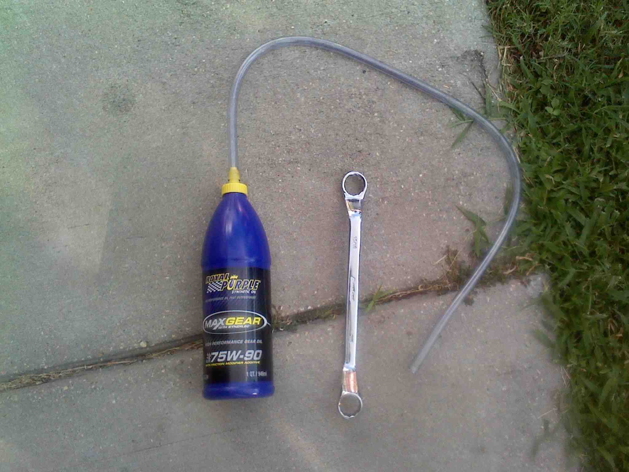

Some fish tank hose and a 15/16 offset wrench worked for me on my 2005. I had to shove the hose about 3 - 4" into the fill hole to keep the fluid from coming back out when squeezing the gear oil bottle. Two bottles is what was needed. After I filling on a level surface, I let the some (not much) gear oil drip back out to be come level with the fill hole. The Royal Purple gear oil has smoothed out the shift feel at the stick. My vehicle has 77k miles on it.

Harbor Freight sells a great pump for like 4.99. Put one end in the bottle and one in the fill plug till it drips out.
