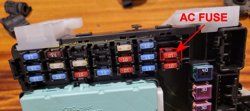

I found a 2003 Vibe AC wiring diagram at download/file.php?id=1733 (and for an 03 matrix at download/file.php?id=5890 )
The Vibe diagram doesn't specifically show the light in the AC switch (the matrix one does), but it does show that the switch gets power from the AC fuse, which is unfortunately in the awkward to access under dash fuse block.
Other fuses involved in the circuit are the GAUGE fuse and the HEATER fuse. If the GAUGE fuse was blown, then you'd be having a lot of other issues. If the big HEATER fuse was blown, then the HVAC blower fan wouldn't work.
Not being able to recharge could likely be that the AC compressor is not turning. It has a magnetic clutch that pulls the compressor shaft against the spinning belt pulley. The pulley always spins when the engine is running, but the end plate only spins when the clutch pulls it in.
If the AC fuse is blown, then the question is why did it blow and will a new one also blow.

The wiring diagram doesn't provide detail on the inner workings of the switch. That switch has two electrical functions: AC on/off and recirc on/off. It seems to me that if the recirc function was powered by the AC fuse, then there would be no reason for the switch to also get 12V from the Gauge fuse so I assume recirc function is powered by the gauge fuse, and then since recirc works, then all that mean is the switch is connected to the wiring harness, which is unfortunate because that would have been the simplest, easiest solution.
Did you ever get a chance to check the AC fuse?

So I pulled the fuse, put a new one in. Turned it on, the light was on for a few seconds and poof out again. Tried with a second new one, same thing
Posts: 606
Re: A/c button/ ac not working
Since it took a few seconds to burn out, it wasn't a direct short, rather excessive load. I'd suspect the A/C clutch. I'd try to get a reading on its resistance. We don't know the spec, but if it's low enough to blow a 10A fuse then it's a problem.

I agree with andrewclaus, sounds like the compressor clutch is shorted
If it was my car, I'd do a quick elimination test. Put good AC fuse in, do not press the ac button, and see if the rear window defogger works. If so, then that means the wire going to the center dash is not the problem. Then, turn that off, and pull the AC relay (in the under hood fuse block, press the AC button, and if the AC light switch stays on (fuse not blown) then that means the short is downstream from that relay. Then turn the AC off, put the relay back in, and disconnect the wire going to the AC clutch. Press the button, and if the AC light stays lit, then that pretty definitively says the short is in the AC clutch.
