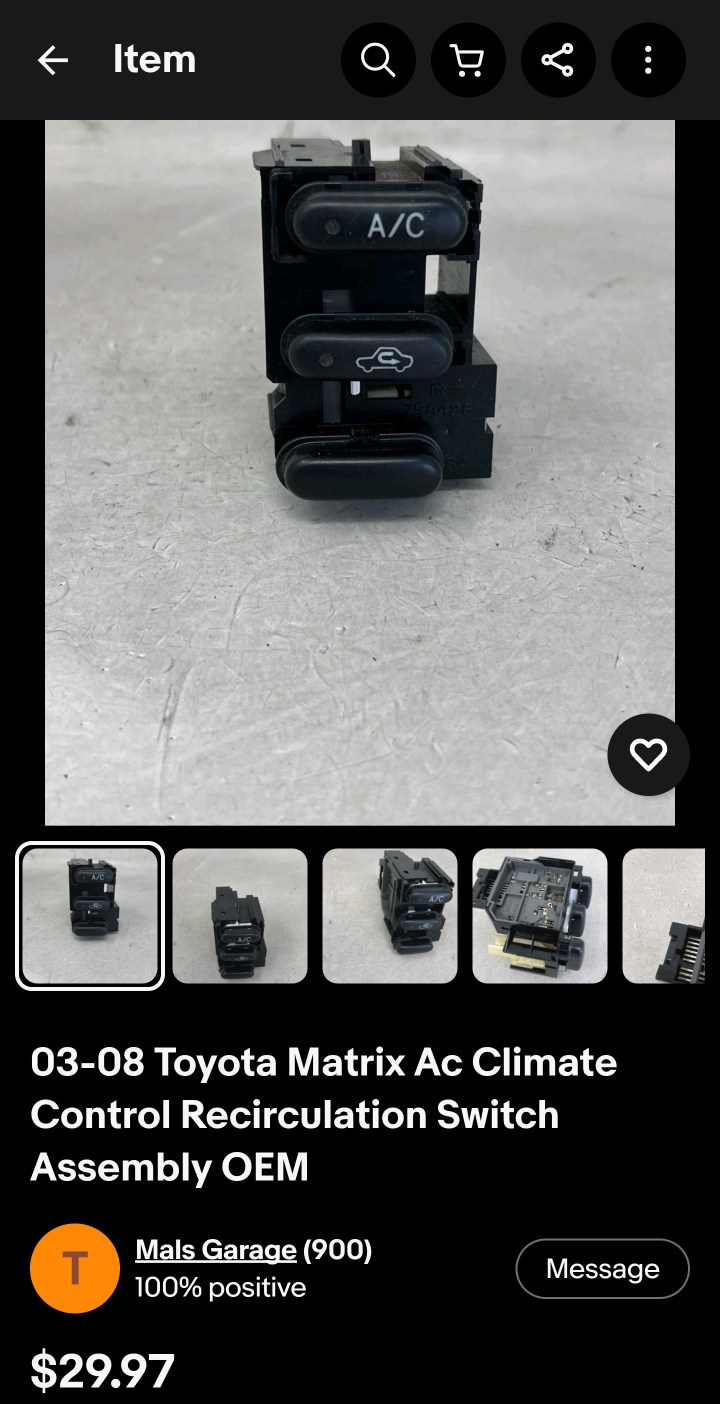

Hi. My suggestion is to replace the AC power switch in the climate control console. I changed a similar part on my 2009 vibe to fix the issue of No AC or blower fan turning on. The heater core was still working on my car. It would still prodice heat to passively defog the windshield. With the blower fan not workimg, my car didnt have enough oomph to defog the entire windsheild but it was still driveable.
I found a AC/recirculation switch for your car on ebay for $30.
The switch for my car looks different but functionally its similar to how the switch is on 2004 2008 vibe/matrix is. before changing this part I did a search for bad fuses but didnt find any.
If that doesnt fix it at least youre only out $30.
There is also a blower control switch and resistor for those generation of vibes but I cant say for certain if those are related to your problem. The upside is those parts aren't very expensive to try either
