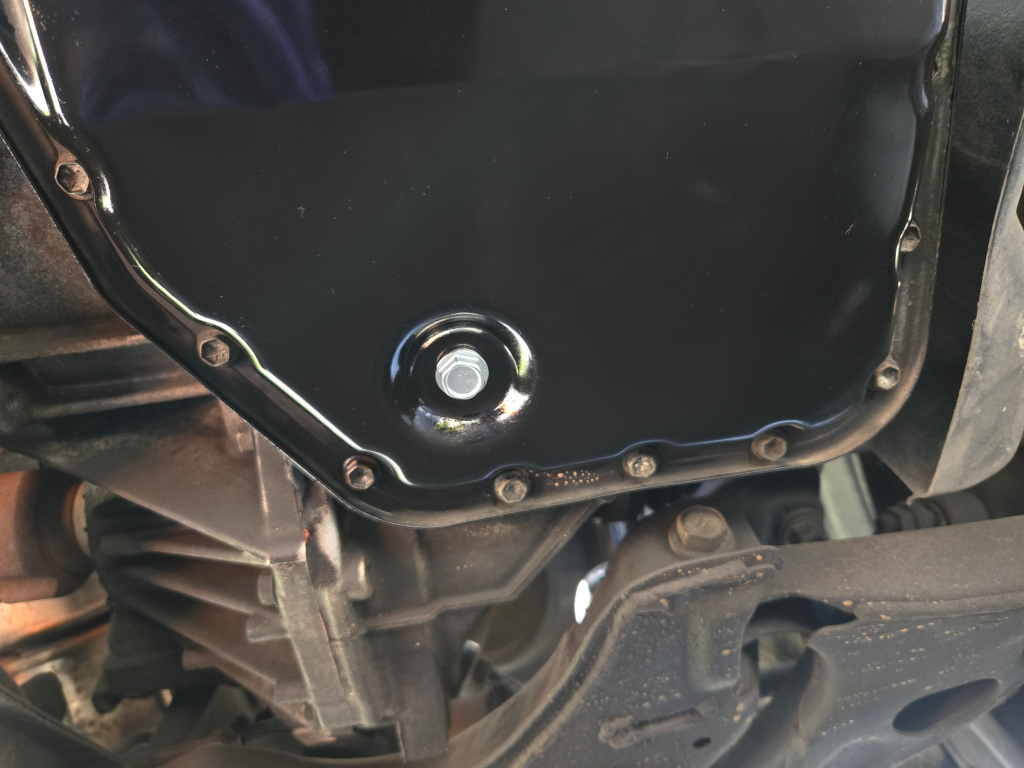

Mark wrote:I couldn't find any T-IV around here, so I went by the Toyota dealer and picked up a case. He gave me a 10% discount so ~$6.50/qt. I also asked about a transmission drain plug washer and yes, there is one. Part number 90430-A0003.
It's a completely different size than the oil drain washer, and it looks and feels more like a single-use crush washer.
Scratch that, it's definitely the wrong gasket for my 04. The washer on my plug is smaller OD that this one's ID. The dealer is ordering a different part to see if it's the right one, he said he found two different transmissions listed for the 04 Matrix.
Here's the one on my Vibe:

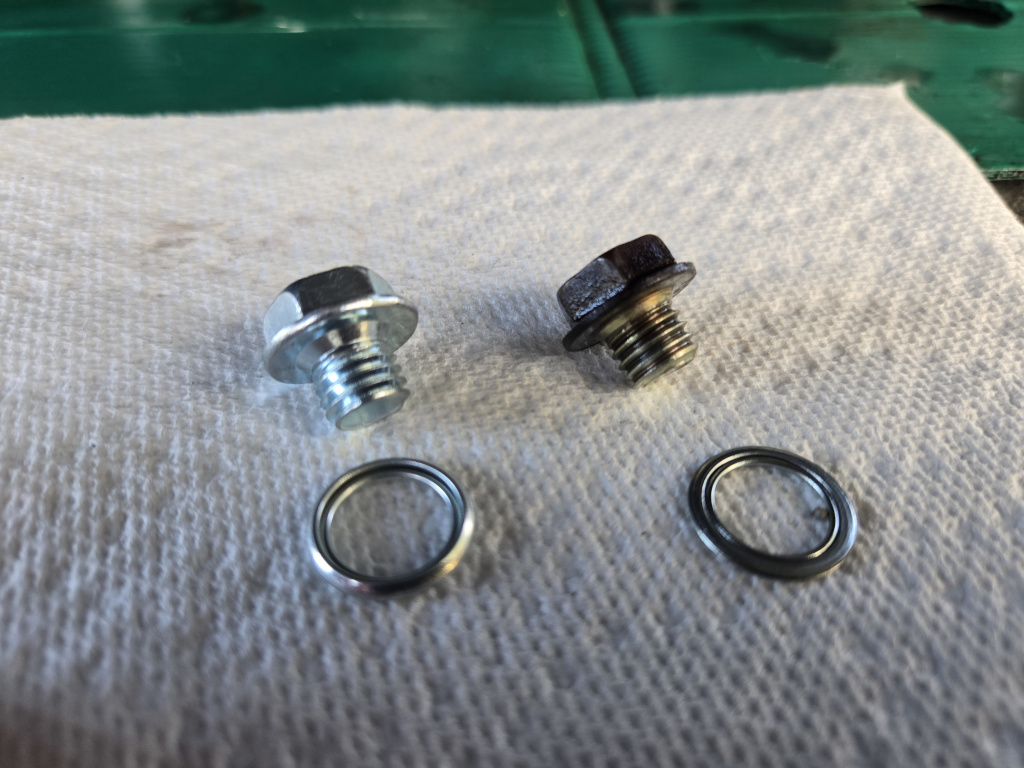

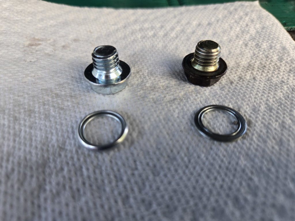

The part number I posted yesterday is the correct crush washer, at least for the 04 Vibe. I bought two and have another half dozen on order. Today is the second drain/refill on Frosty, and I haven't decided yet if I want to do a third or not. I also plan on doing at least two on Stealth when I get that back.
This is definitely a crush type washer that should probably only be used one time. I reused the one that was on Frosty last time and didn't have any leaks, but I think I'd prefer a new one each time.
Mark

Here's a couple pics of the new and old washers together.
Posts: 8442
Re: Transmission: Drain & refill @ 180K or drop pan ?
Greatly appreciated, Mark!
