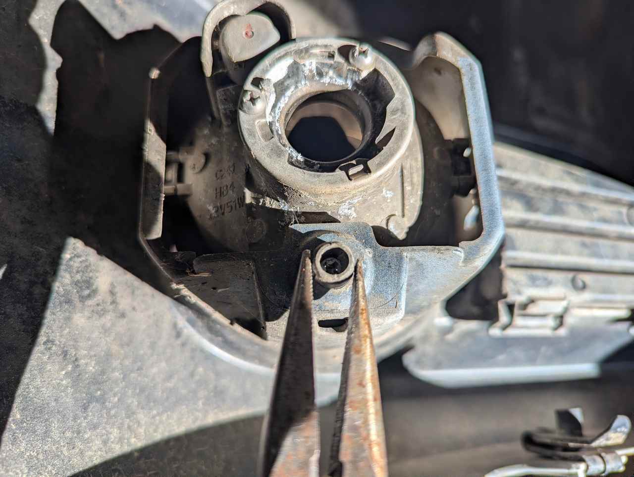

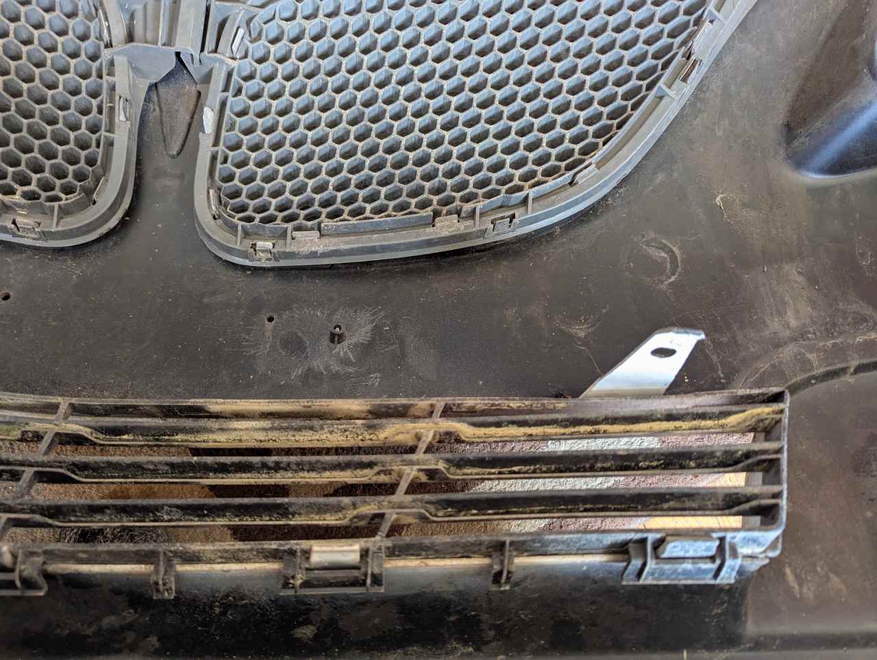

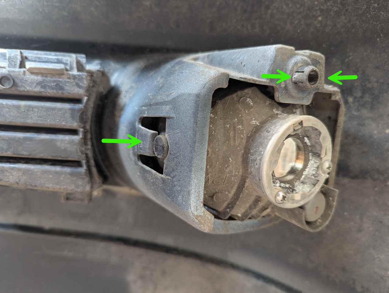

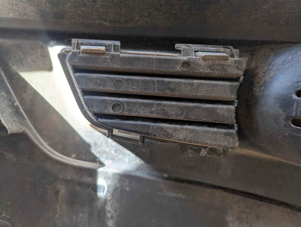

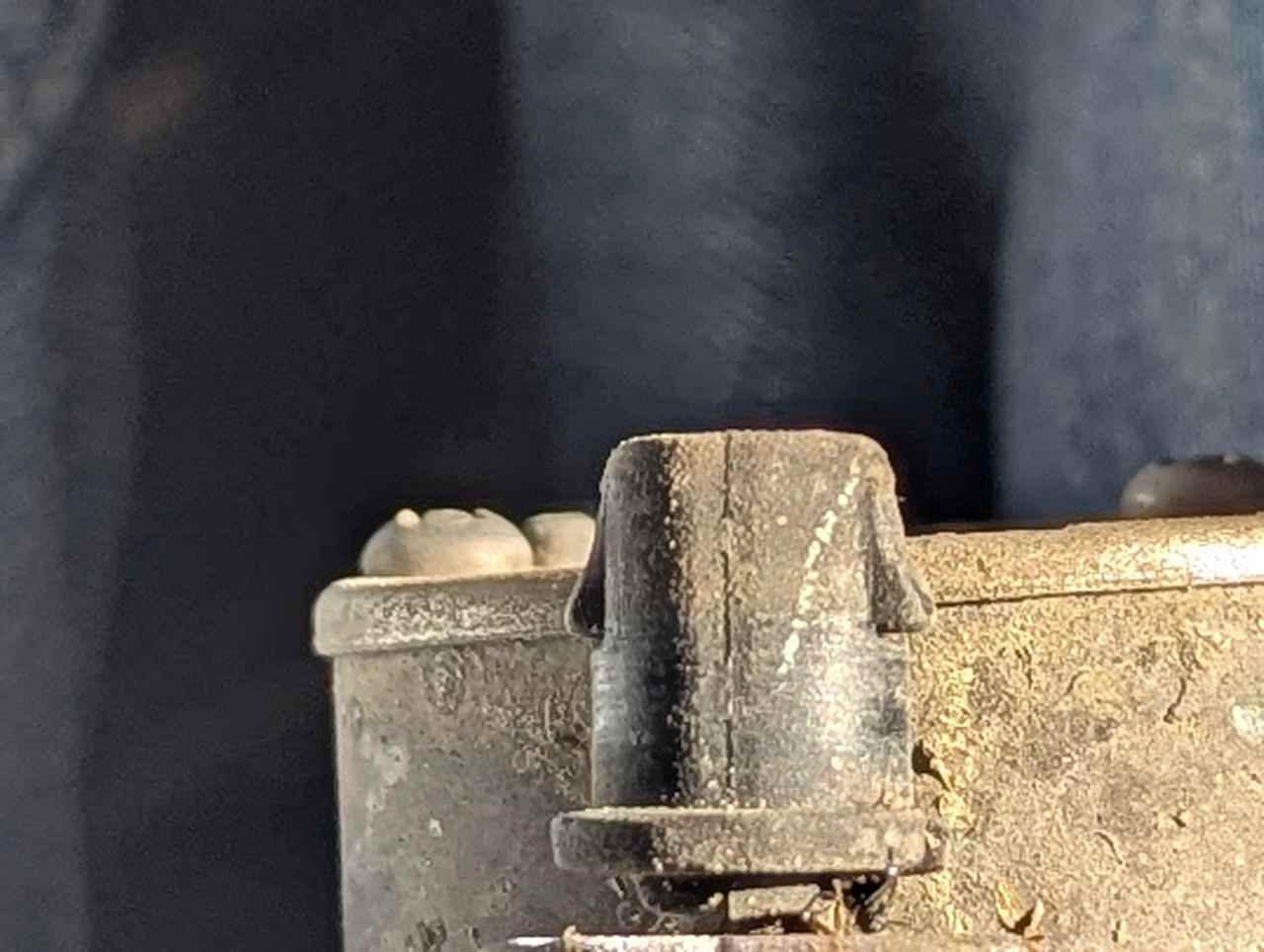

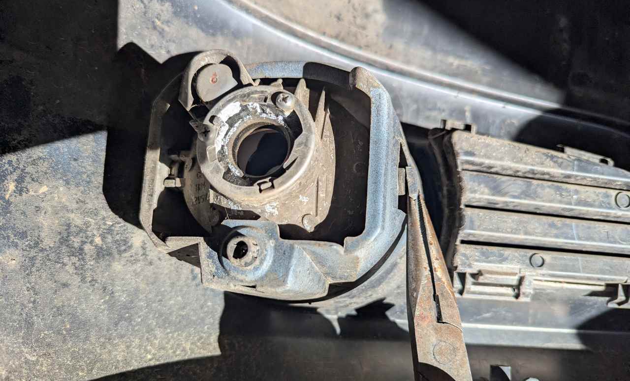

Thanks for the ideas on this. You were correct, the attachments for the grill and all the other trim and fog lights in the bumper cover are accessed from behind. No hardware involved, just clips molded into the bumper cover that you push to release. Here are links to photos from behind the bumper cover in case this of use to someone else.
Egg crate grill insert
Small side insert
Bottom insert
Fog light attachment points
Squeeze both tabs on the fog light aiming screw
Gently pull on the side tab to release fog lamp
Close-up of tabs on fog light aiming screw
